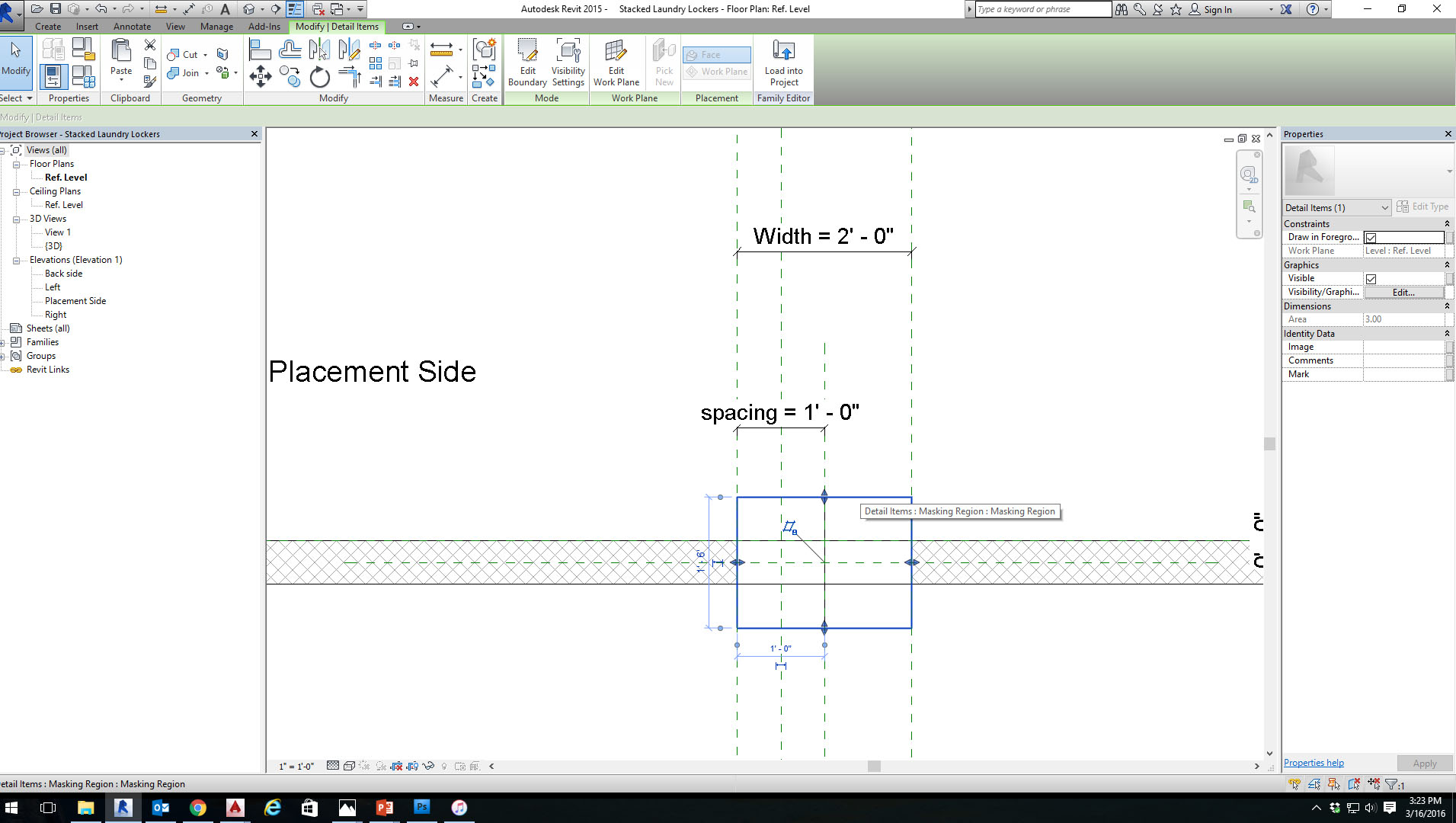

I'm new to Revit so please bear with me. Normally when I create a masking region it hides everything behind it, walls, extrusions, etc. For some reason this time when I created one it isn't hiding anything. I'm not sure if that's due to the family type I used this time around or what.
The region in the attached image is just there to show it doesn't mask anything. The family is just a simple array family that multiplies stacked lockers (that are joined as a group) as many times as I want it to.
Any assistance would be awesome. Thanks!

I have no idea what I changed, but it just started working. Does anyone have any idea what I did?

Masking regions only mask modeled elements. They do not mask detail items and detail or symbolic lines. To me it looks as though the masking region is hiding the modeled elements as the hatch pattern is not visible behind it. However it does look like you have detail lines the run along the edges of the extrusion. Thats my best guess
