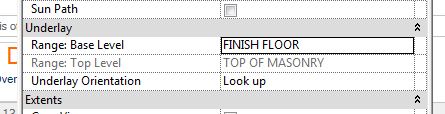

If you are using Revit 2016 and have the current updates, I believe you can see the lights above in your floor plan view by adjusting the underlay settings to "look up".
Mon, Mar 14, 2016 at 12:31:44 PM | view range
Johnzo - thanks for pointing this out - I had not seen this yet and I don't believe it is listed in the new features.
NOTE:  This feature or functionality is available only to students and to Autodesk Maintenance and Desktop Subscription customers for Revit 2016 software releases.
