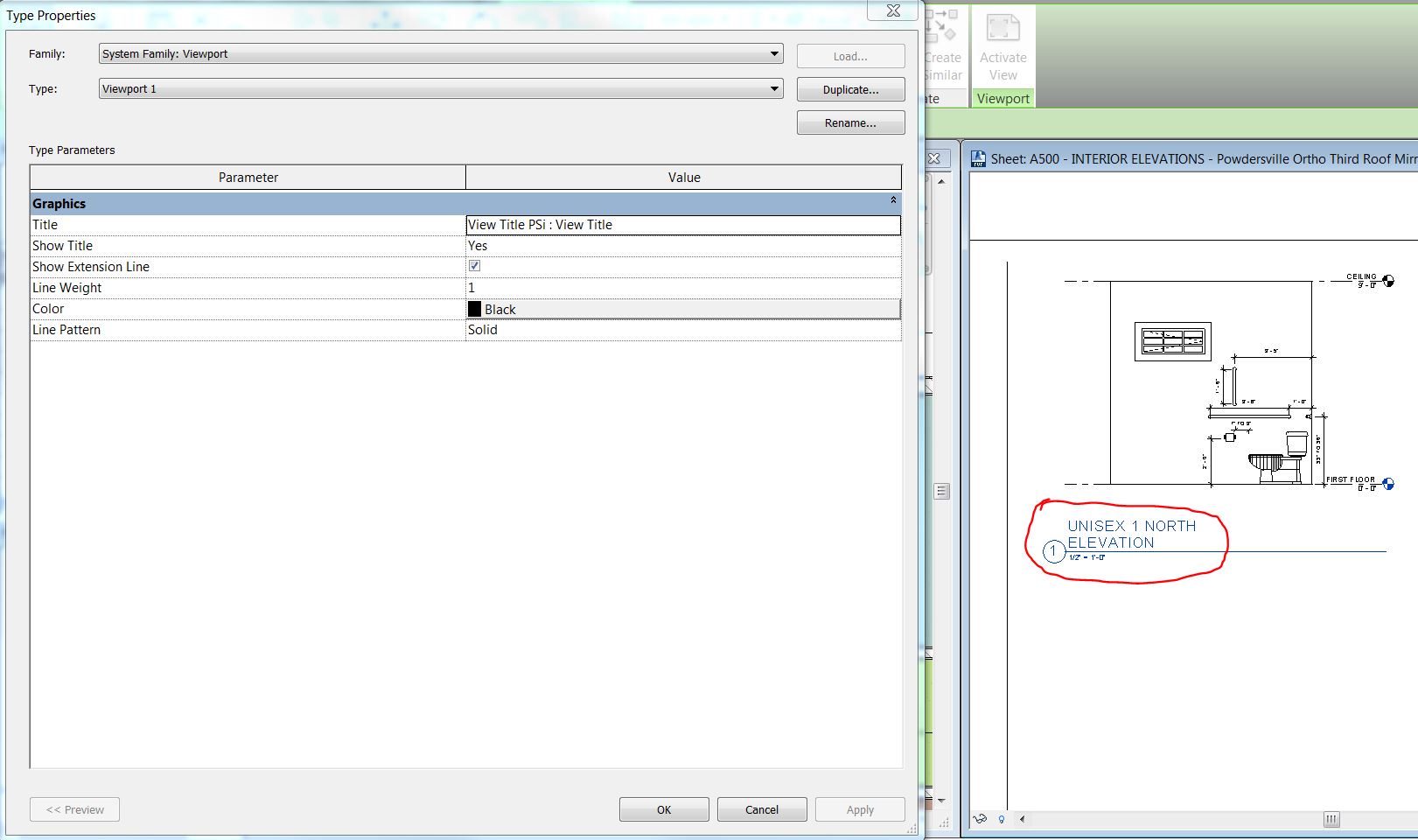

I am working on putting my views into sheets in Revit 2016 and when I do this my text doesn't show on one line. Usually I am able to adjust the text box to fit my text but it doesn't seem to be the case with viewport / System Family: Viewport. Is there a way to do this? I have attached a picture of my viewport text.

hi Lavendert8,
You can edit the text box size of the label from within the family itself.
On the Project Brower, go to Families > Annotation Symbols > View Title
Right click on View Title and select Edit.
Hope that helps.

I wasn't able to right click and select edit but I was able to locate the family in my library and edit it that way.
Thank you!

Under the Project Browser look for Annotation Symbol then under it the M_View_Title then right-click then edit..
