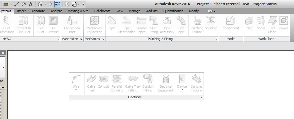

Do you have two screens?
Did you know you can rip the sub-menu off the menu bar and place it elsewhere like my image?   Like on your other screen where it may be hidden by something else.
