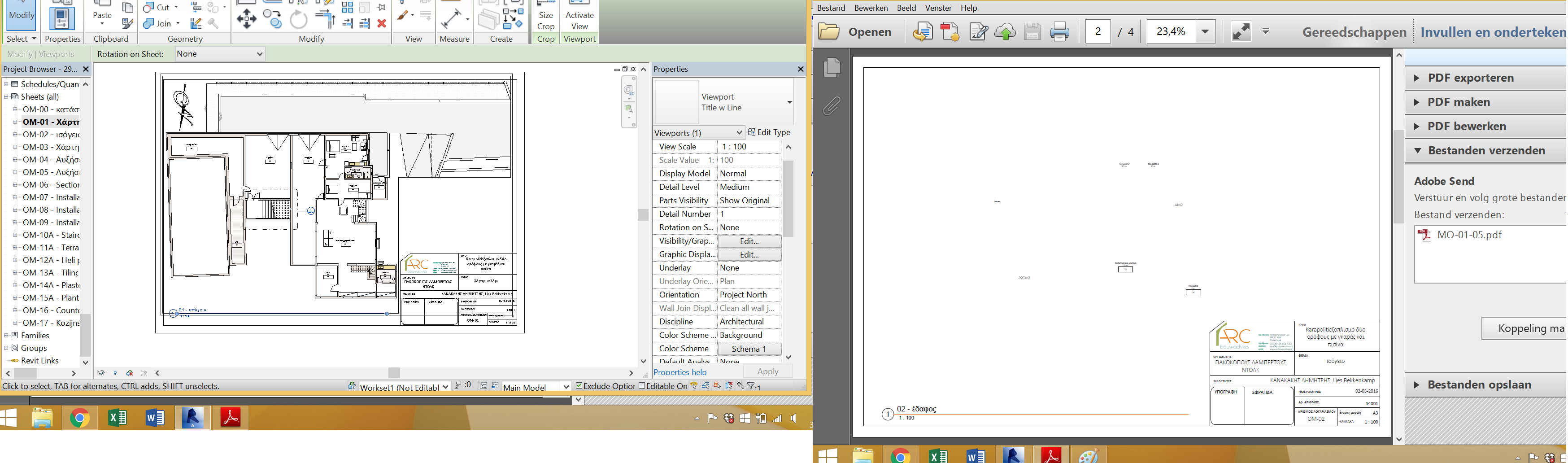

I'm trying to print  my basement and ground floor level but everytime I do that almost evrything is lost and I don't know how I can fix it. In the attachment you see a print screen of the revit and on the right a print screen of the printed page. As you can see almost evrything is gone except for some tags and symbols. ***!! Please help a woman out

Tell us more:
  • Is any of this CAD or inserted images?
  • In the view, is there anything that is temporarily hidden?  Temp settings are removed when printing.
This may be a printing problem.   Try printing to a different PDF program like Cute.

I downloaded Cute and that programm printed it perfectly. Thank you so much for your help WWHub!!
