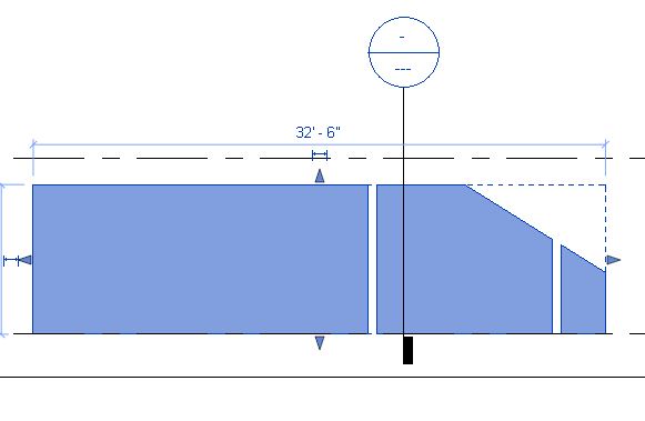

I made a wall, used EDIT PROFILE to put a slight slope on it. I'm trying to put a vertical reveal but it can't cut the wall. Is there another way to slope the wall that will allow me to place a vertical reveal?

You realize that slope is not a good description?
Look at the images.
  1. This wall does not slope, it has a sloping top I created by edit profile.  As you can see, I can place vertical reveals.

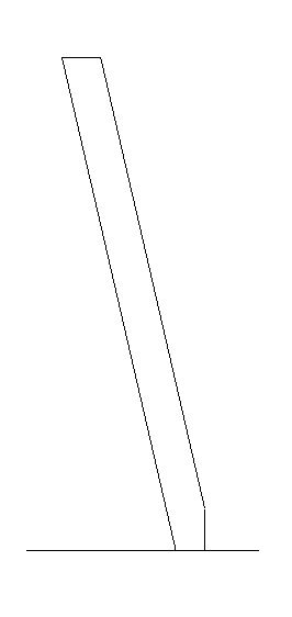

  2. This is a section view of the same wall.  It appears to "slope" because I used edit cut profile.   It only appears to lean but that is only as a 2D View - not modeled.
Cut a profile with a reveal?
