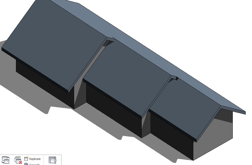

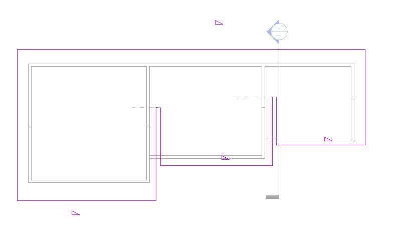

Mon, Feb 29, 2016 at 11:24:33 AM | How to create a gable roof with sloped eaves
Here is my test.... you have to play around with the one wall where I show my cut.  That wall will not attached to roof so I had to sketch it.

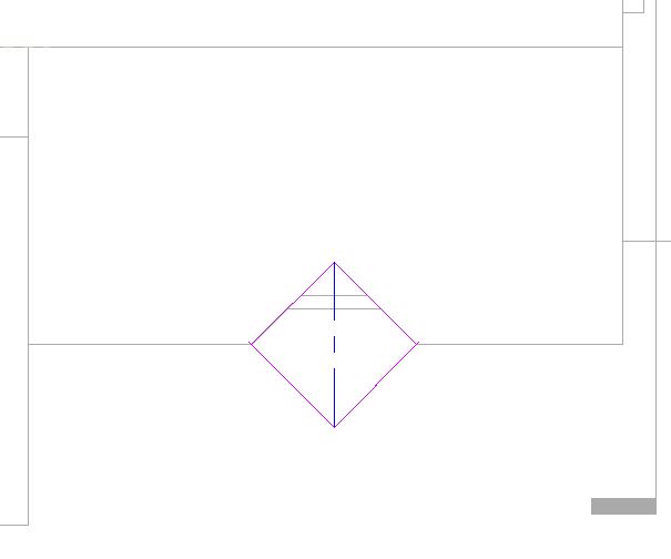

Your response did not answer my question- if you look at the pdfs I attached- the element I am having problems with the roof is the triangular entrance structure. with a typical gable roof the Rake edge elevations vary, while the eave edge maintains a consistant elevation, with my problem it is the eave that I need to vary. Thanks

sorry - I did not see that question from what you gave us.
Do that roof as a seperate element and knotch the side of the other roof sketch after you define this roof.  Use a slope arrow instead of slope defining edges.
BTW - you should still look at my first answer to help you with the other roof.

Please re-read my previous post.  SEE SLOPE ARROW... Look at the sketch - the slope area goes from corner to corner on this roof by footprint.   (Sorry that you can't see the slope arrow on that roof sketch but that is what defines the slope and it looks like a centerline.)

Thank you both! I read the Centerline as the ridge- I see now that the slope arrows have to go from Ridge to the corner where the
entrance roof connects to the main building roof.
