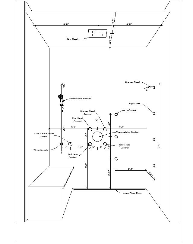

Hello everyone.
So I'm strugling trying to find a way how to do something like the attachment pic. We are working in a bathroom that has a full shower system like the one in the pic, and I have to do a view like this one. I have search and read about working in perspective view and axonometric and I know you can't measure in perspective view. So what I would like to know if someone has any idea how to make something like this in Revit or even using another software for help.
Thanks in advance!
Revit 2019 / Windows 7
Thu, Feb 25, 2016 at 8:36:22 AM | Bathroom perspective with measurements and annotations
You can oly dimension in axonometric views in Revit.
You could export perspective to CAD and adsd fake dimensions.   A poor choice I think.  We show a perspective view with dimensioned plans and elevations.
Thu, Feb 25, 2016 at 8:45:22 AM | Bathroom perspective with measurements and annotations
arqrivas
Joined: Thu, Apr 17, 2014
0 Posts
Ok, I guess that's what I'm going to do, Yes is a poor solution but at least I'm going to get it done.
I hope we'll have tools to annotate perspectives views in the future in Revit.
Thanks WWHub.
PD: I'm still open to any ideas if someone else has another idea.
