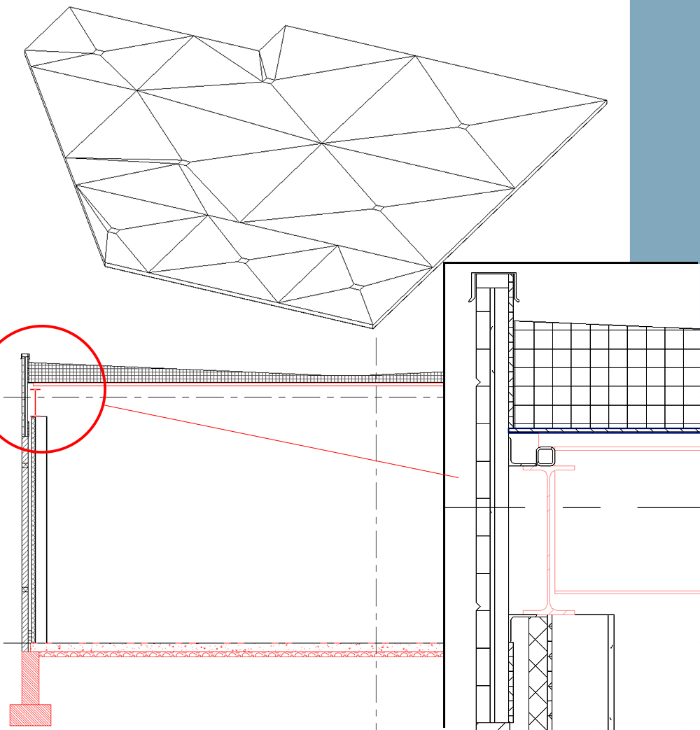

hello all,
I have a flat roof that has variable rigid insulation slopes in order to drain water at various points within its perimeter.
in the same assembly there is also a 1/2" plywood sheating base below the sloping insulation.
I would like to break that into parts, but after reading various web posts and trying it, it seems that roof shape editing
of a variable height layer (my sloping insulation), automaticly "kills" the create parts button.....and vice-versa....if I create
parts for a flat roof version, and even try to activate shape editing, revit will delete the parts......ugh
anyway around all this?....where I can have both parts and sloping insulation in a multi-layered roof?....or do I have to
just keep the layers as separate elements?
thanks
PS: using revit arch 2016

not sure I can achieve what u mention in my case w/ just a in-place fam....esp. all the drainage slopes I need
here's a 3d bird's eye view, and a section cutting through a small part of the roof.....it's slopped insulation over 1/2"
sheating, over metal deck, the overall assembly.....the metal deck and rest of structural is in its own structure file (red)
while the sheating and slopped ins. is in the arch file....at this point I just ended up having the sheating separate
from the slopped insulation, because at time the sheeting needs to end closer to the wall elements then the insulation.
anyway here's an image....it's still a work in progress...

Just use a floor slab. Set the right thickness to suit your required roof buildup. Set the floor slab plan profile to the correct footprint shape. Then select the floor slap and adjust the spot heights all across it to suit your calculated falls.
Here's a youtube video to explain adjusting spot heights.
https://www.youtube.com/watch?v=cbudDb31Vzk
Cut out holes for drainage gulleys and add in family category objects as required.
