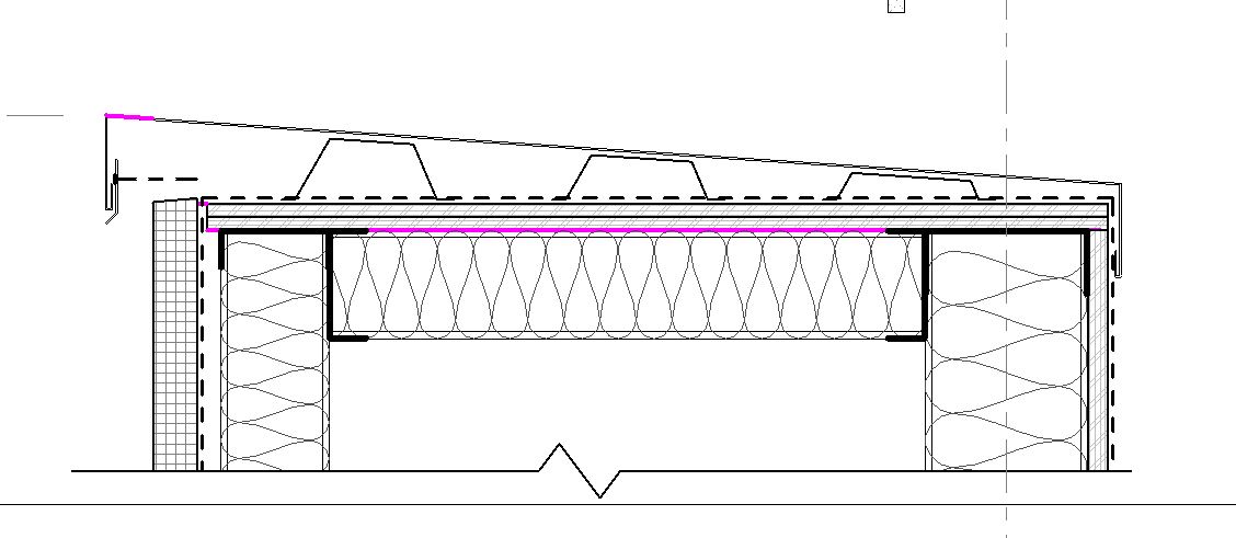

In Revit 2016, how do you turn off the pink cut profile sketch lines?  I cannot turn off by element or category because I cannot find it in the list.  If you use cut profile on a wall and later decide you dont' really need that wall and turn it off, the pink sketch lines will be left behind and print.
Yes, I realize I can delete the cut profiles if I'm not even going to use the 3d wall, but I'd like to keep them in case I change my mind.
Wed, Feb 17, 2016 at 11:07:50 AM | Cut Profile Visibility Settings
Thes lines are annotative, not model and they are view dependent.  I do not see these lines at all if I turn off or hide the cut profiled element.
Typically, I only see the pink lines when the cut profiled element has been altered somehow and the sketch is now orphaned.   In that case you edit the sketch to correct that or you delete it.

Sketch lines? When you're NOT in Sketch Mode? Weird. Please post your findings. Thanks.
