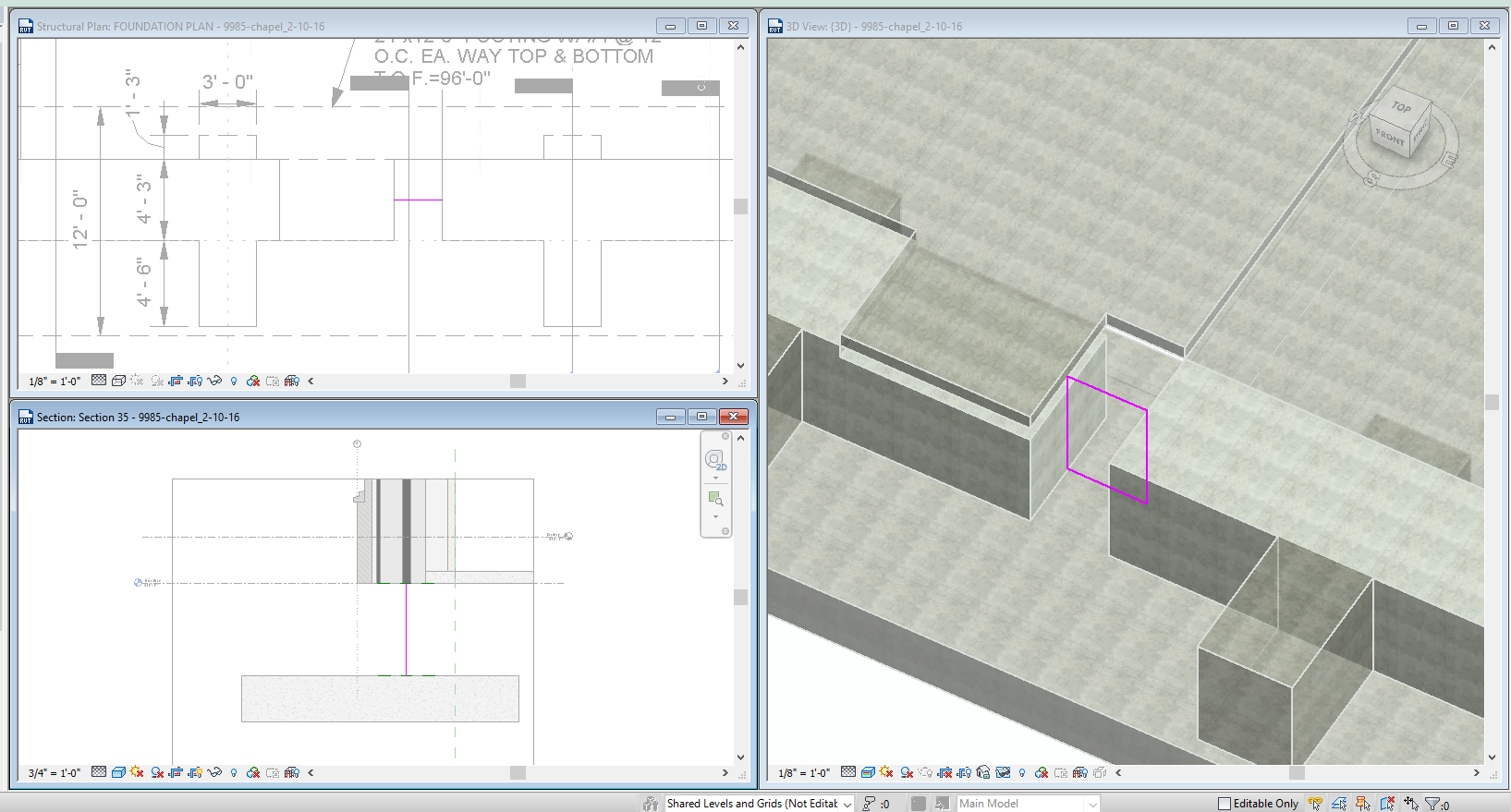

I need to edit the profile of a foundation wall to have a curb on the inside face of this structure. However, when i go to edit the profile of the wall, its wanting me to edit it in the wrong direction. (i need it to rotate 90 degrees) Is there any way to change the direction of the profile of a foundation wall? Please see image for clearification. thank you for your time.

Some options.
1) Rotate that part of the wall 90 degrees and then edit the shape to suit your needs.
2) Create an inplace family (I assume its just solid concrete)
3) Its hard to exactly see from your pictures what you are achieving but you can also attach a foundation to a wall in any profile shape that will follow the wall to whatever percentage of it's length you need.
I hope that helps.
