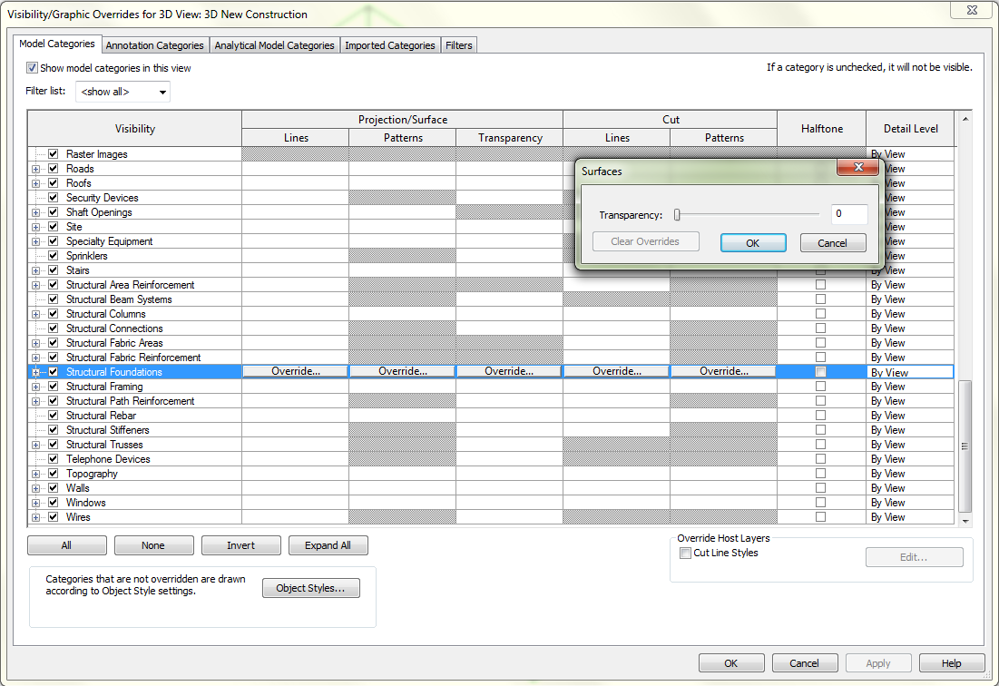

Here's what I want to do -- I want to show a concrete column and a foundation wall but also be able to see the rebar inside. I'm thinking of drawings for the building department (and also the construction crew) -- to show them that the rebar is properly placed inside a 24" concrete column and a foundation wall. This would apply only to 3D views.
I know how to make an element "hidden" -- what I'm asking about is I guess what you would call partial transparency -- like a cutaway drawing.

So what you need to do is to open your 3d view and then go into the Visibility Graphics settings and then down at the bottom where it lists all the structural items you will want to override the transparency of the structural columns and foundations. I hope that helps.

On an individual basis, you can also right click on an item and choose Override Graphics by Element and change the surface transparency of that item.
