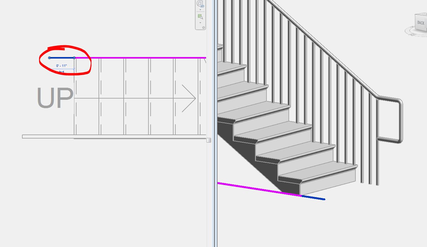

I'm modeling a set of stairs with railing and ADA extension, but my balusters will not reach the floor beyond my last step. anyone know how to fix this? I attached an image
Thank you, much appreciated

Just add a piece of rail at the bottom, see pic.
