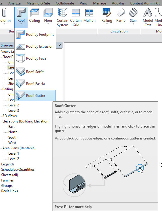

Hello there,
Revit has provide gutter add to the roof, see the picture, but I wonder what about downpipe? How do you use downpipe? I am curious.
I am on Revit Architecture.
Let me know.
