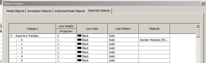

Please pay attention to what we repond with.   As I said "If the autocad file was built correctly, it can stll be controlled.   Materials are assigned to autocad solids on a layer basis ".   Take a look at my image.  Do you see the material assignment per layer?
