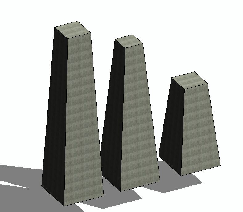

I have no idea what a wedge pile foundation and your 2D drawings don't tell much either.
I am going to assume it is the cranked shape on section d-d and b-b.
I would use an inplace family and use a solid blend to make one shape at the top extend downward to a required length and change into a different shape at the bottom. Or if you have a number of them and they have differing lengths and top/bottom shapes, you could create a parametric family that allows you to adjust the length and shape sizes to suit. Kind of like the attached image.
