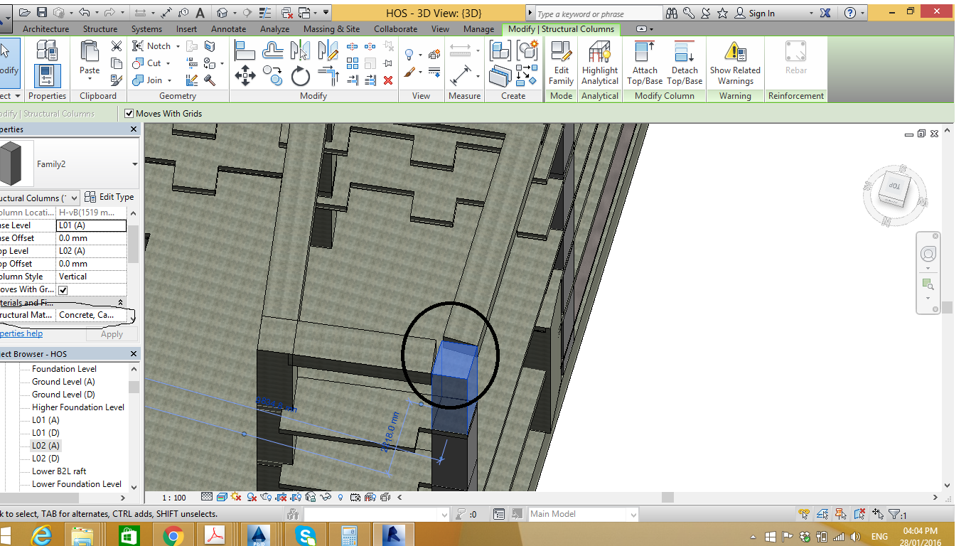

Hey guys, I have a problem with a column that I have made its family. first of all I have noticed that its apparent isn't like the rest of the concrete elements although I ensured that it has the same structural material as shown in the screenshot. now the main problem i am facing is that the beams laying on the column don't intersect as shown. I extended it to the middle of the column but no use!!

Are there two columns in one spot? try deleting it and see if there is another there. Or try deleting it and redoing it. Drag beams clear of column and drag them back again to reattach.
