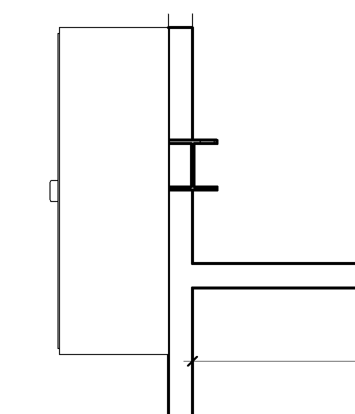

Hello!
Probably I am missing something very easy but, How can I make this Furniture to show below the wall so it doesn't cut the Lineweight of the Wall?
Tue, Jan 19, 2016 at 7:01:02 AM | Lineweight Problem
Sorry - no way to do this that I know of with model elements.   Move the piece slightly off the wall.

Ok, Thanks. I just thought this was something basic that I just missed.

You could try using the linework tool under the modify tab. set it to invisible lines and then click the the line of milwork against the wall
Tue, Jan 19, 2016 at 1:03:18 PM | Lineweight Problem
This will work for some families but typically you don't use invisible lines, you would have to use the lineweight of the wall for the familly.  However, it does not work with all furniture families, it changes all of the lines for some.  Only those that have symbollic linework will work.
Still worth a try.

Yeah and usually you only want to use the linework tool in detail views but i figured might be worth trying is its only one location in the plan. I am thinking it is likely a problem within the family with the extrusions and sweeps or what not and thier visibility priorities.
