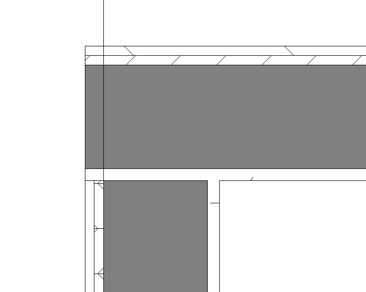

GRR, my corner wall clean up won't work.  See picture below.
I did modify the wall on the bottom so I can stretch the exterior sheathing and siding down over the end of the floor joists.  But when I do that, my walls look like this in plan.  Any ideas?

wall joins|mitre

Tried to trim?
Try to move the finnish faces outside the coreboundry in the properties.

Yes of course I tried trim and wall mitre. I want the exterior materials, they ARE outside the core boundry? Oh my! This is a terrible dilemma.

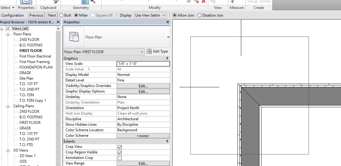

Hello!  I got it!  The wall miter was the answer!  I just didn't know where it was!  So bad that when doing things, I don't look at top or bottom ribbons that give you options or instructions.  Lazy AutoCAD ways!
See image below.  The surround box goes away as well as the 45 degree line once I am out of the command.
Thanks for all your help!

Glad it works out for you but mitter is not the preffered way.
Only use it when nothing else seems to work.
You have a simple wall and it is a simple join, revit should clean it up by itself (check the immage).
If not there is something wrong with your settings.
I don't think you'll like to mitter over 2000 corners when you'r working on a large scale project.
Your project so work with your preffered method, just trying to give some advise ;-)
