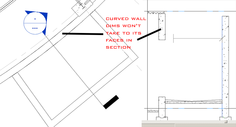

Hi all,
I have a curved wall that appears in a section, and would like to be able to dimension from its faces, but it doesnt
seem to work.....is there any way of doing that, short of drawing dummy detail lines at its faces, and measuring
from those?
see attached.....any help would be appreciated
thanks!

You can't put a dimension to this wall.
You should not place horizontal dimensions in a section, just heights.
The rest of the dimensions you should place in the plan view.
