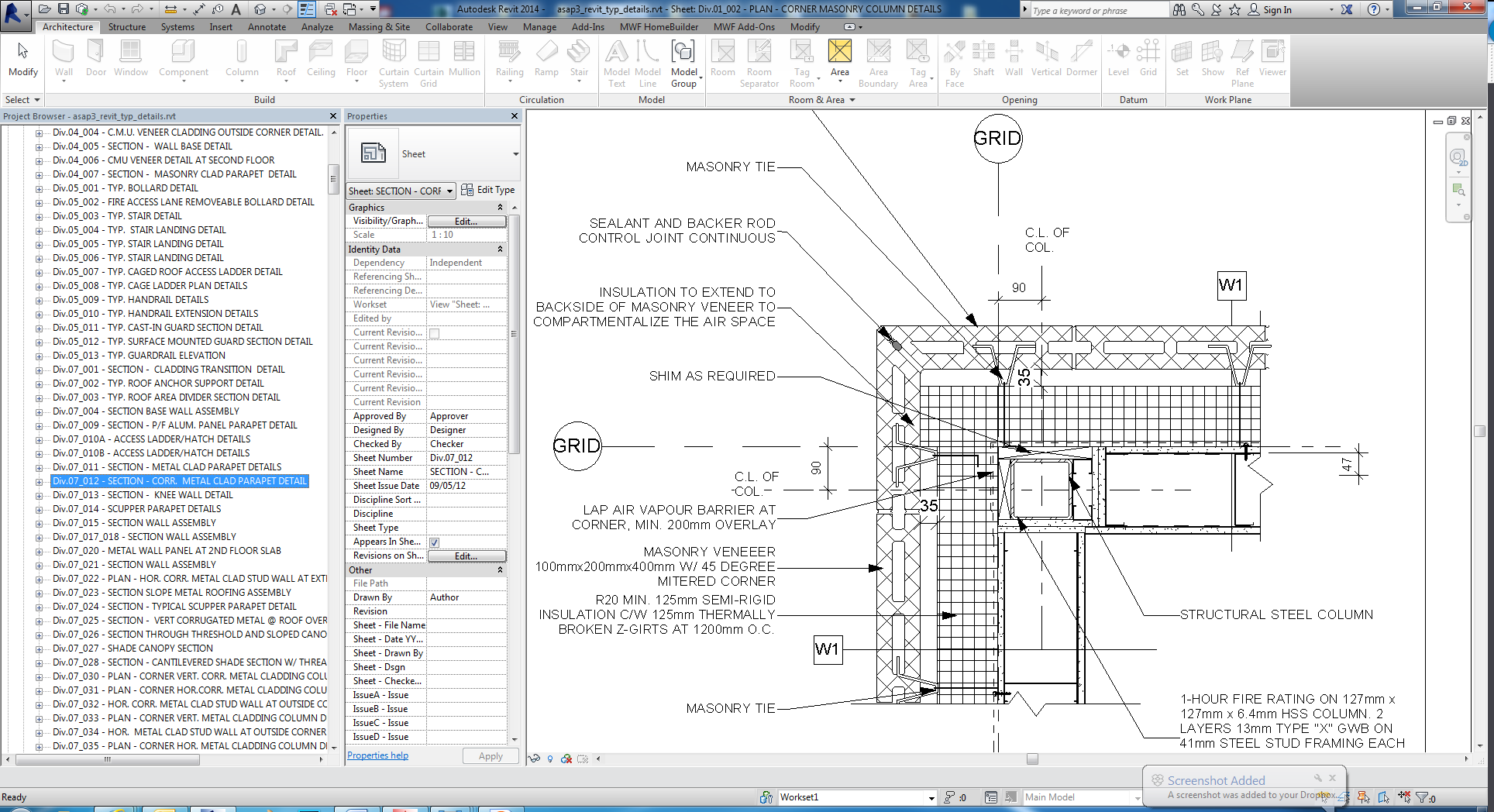

Ok once again for clarity....
I have a revit project within it are about 300 drafting details each on their own view and each on an 8x11 sheet.
The project was created to house all our standard and typical details for our arch drawings. It is a detail book.
I wish to pull each detail from this one Revit project and place them in a folder according to their master format name and division.
I can right click on the view or sheet and save to new file. This is tedious for every sheets so I was wondering if I can extract all sheets to a window explorer folder as an example publsihing to PDF multiple sheets.
See attached.
