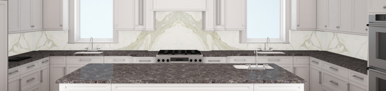

Hi everyone!
I'm doing a backsplash for a kitchen with 60" x 120" slabs. But there is a specific design and way to apply them in the wall, and I need to put them as real as possible so we can have the amounts of slabs we are going to use and how it will need to be cut. So I need to align the texture to a piece of geometry and make the pieces with the corresponding real parts of the slab in order to achieve and show the design intent.
So does anyone knows how I can do that?
Here is a image, this is the kitchen and an idea made in photoshop of how I need to put the slabs and what I need to do.
Thanks!

This is not a 'texture' as we normally use that term because this, I assume, is unique for each slab.  As such, I don't see any way to do this with a 'texture' map.   There is stone layout software that does this automatically.
