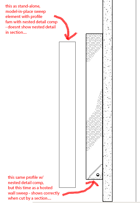

Hello,
thanks for the quick reply!
so I went ahead and followed the help on creating a sweep profile family with details comp nested in it.
it seems to work....well, kinda, in certain situations....and my question is if it can work in both.
1) after creating the detail/nested fam profile (used the simple profile template, not the "profile - hosted"), I loaded it up and tried creating an in-place-model element with a sweep, that had as a profile the nested profile family....however when cut w/ a section it didnt show the nested detail!.....tried and double checked view detail levels but nothing...
2) so I tried applying the nested profile then as a simple wall sweep part of a basic wall....and this time it worked!...showing the detail when section-cut....
my question is why wouldnt it show also in the first case?....when it's part of a stand-alone sweep modeled-in-Place?...is there anything I can do to make it show there as well?.....I'd prefer that situation, but I can live w/ the wall sweep too....
