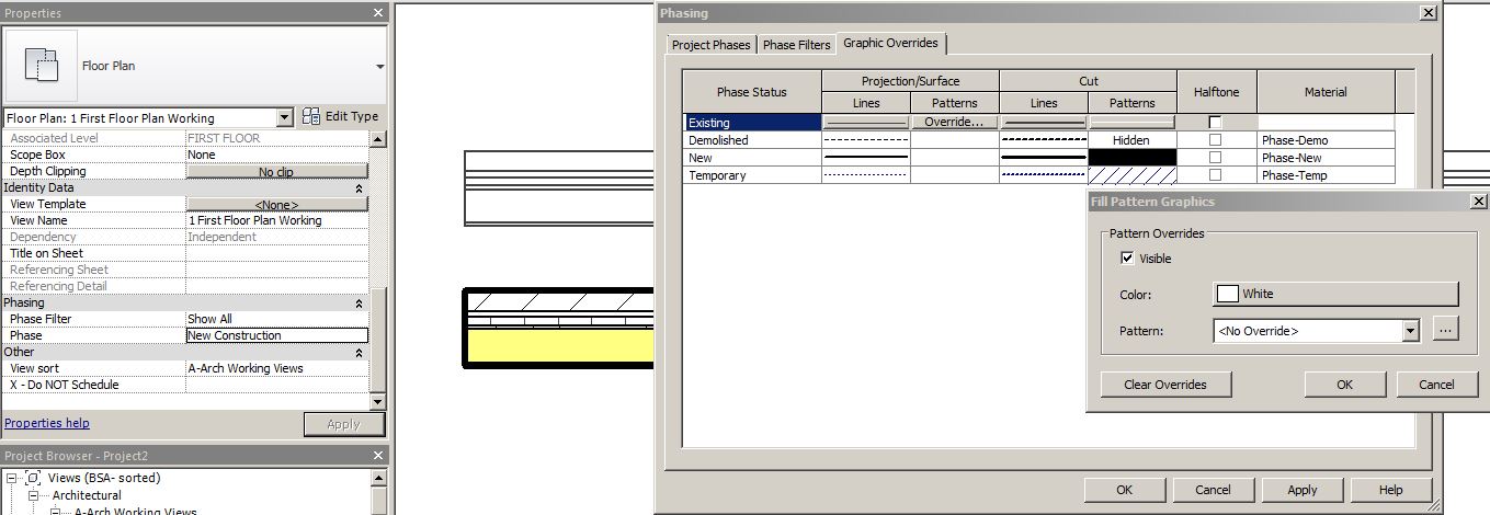

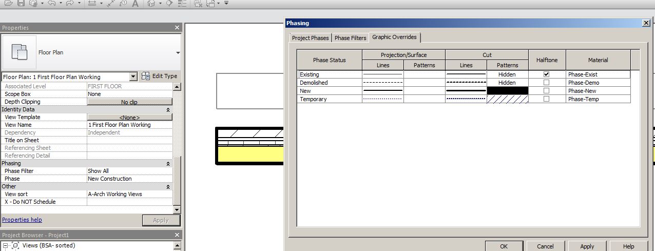

Do you walls actuall have layers? Post a screen shot of exactly what you are seeing.
Wed, Jan 13, 2016 at 9:42:28 AM | Phasing Graphics and Detail Level
Here are two walls - same construction.   Upper one is existing.   Look at my Graphic over-rides.

@WWHub- the way you show the existing wall does not meet our needs. We want to show the layers within the wall for both proposed and existing walls.
The way the proposed wall (on the bottom) is displayed is exactly what we want. I don't understand how the graphic overrides shown result in the wall display shown, though. It looks like you have a solid black fill set for the new construction walls, and that's not how it's showing. What am I missing?

Wed, Jan 13, 2016 at 11:24:29 AM | Phasing Graphics and Detail Level
Is this what you want?
Note - chosing no material does work but you also have to have the pattern on and then set the pattern color to your screen color.
