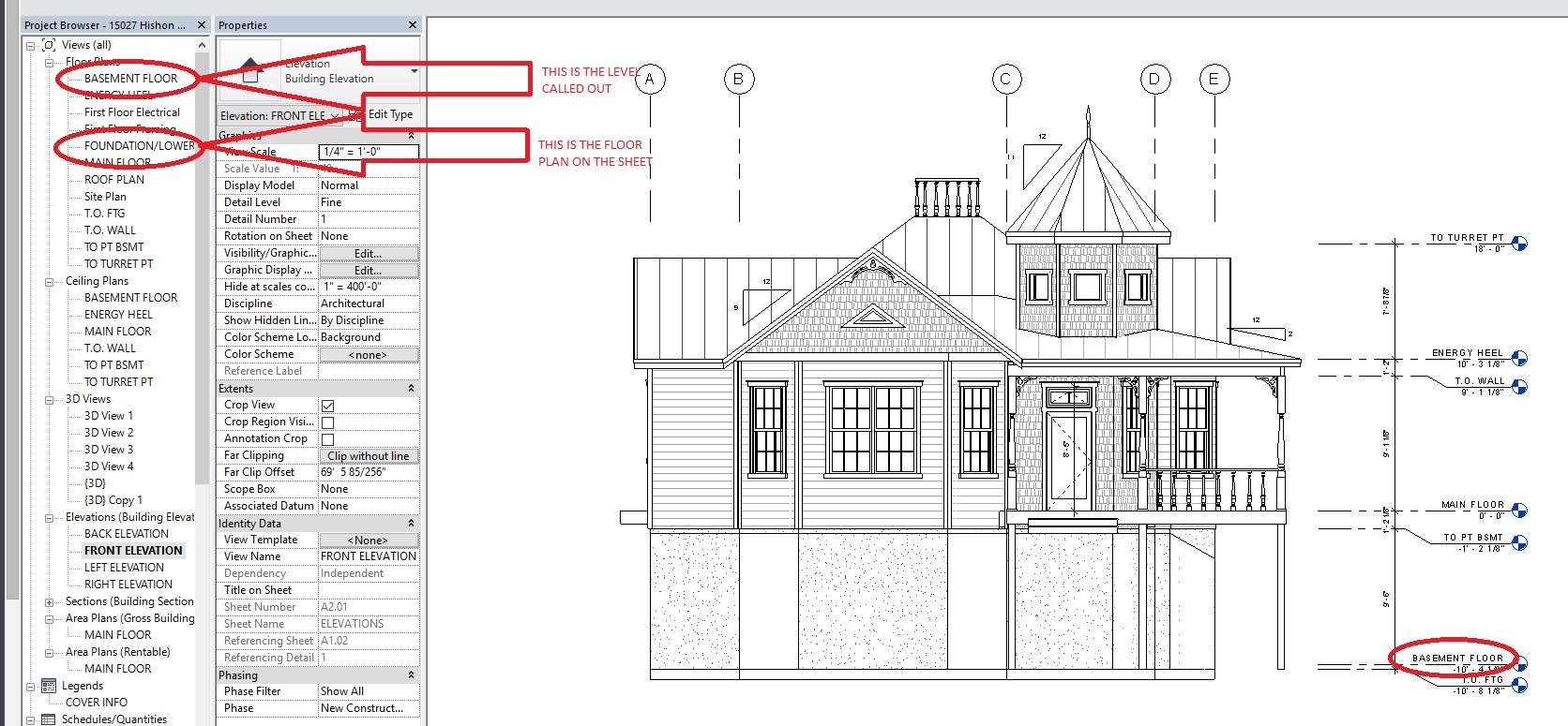

See attached.  I created another foundation plan, but it is not a level.  How do I make the foundation plan be a level?  It is all noted up and dimensioned.
Thanks so much for the help!
Thu, Dec 17, 2015 at 1:07:11 PM | ROOM BOUNDING ISSUES
Create your level plan from the view tab.   Now open your annotated tab and window it.  Use the funnel filter to exclude all model elements then copy to clipboard.   Open your level plan and pase aligned or paste same place.
