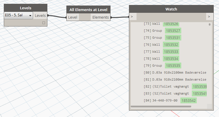

The roof on my building was raised, and so I changed the roof level.  The hosted roof drains moved as I expected, but it also raised elements that were associated with that level, mostly by mistake.  Is there a way to do a search for all items on a particular level so i can change them to their proper level, and if they moved I could move them back.
Thu, Dec 17, 2015 at 7:13:23 AM | How to find elements on a certain level?
Nearly impossible to do.  You can start with a multi-category schedule and include level and maybe family.  Many elements do not report the level they may be associated with.

You can do it with Dynamo.
