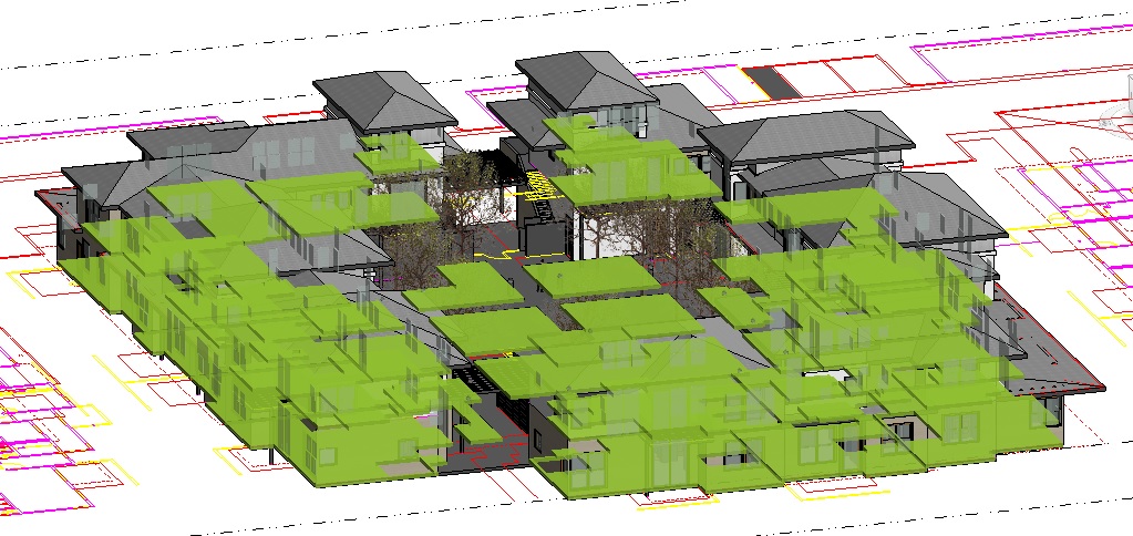

Hi, I have a problem with the flooring appears to be floating in transparent green when viewed in 3D, but it is attached exactly on the floor level. I hope you could help me with this.

What version of Revit do you use? Might be a problem with the driver of your graphic card.

More than your floors - also some walls.
Make sure your view is set to hidden line.  Check your material settings.
If you did not setup the model, then check your view settings and over-rides.

We are using Revit 2013, it might be with the video card, since I am using a laptop.
Used hidden line view instead.

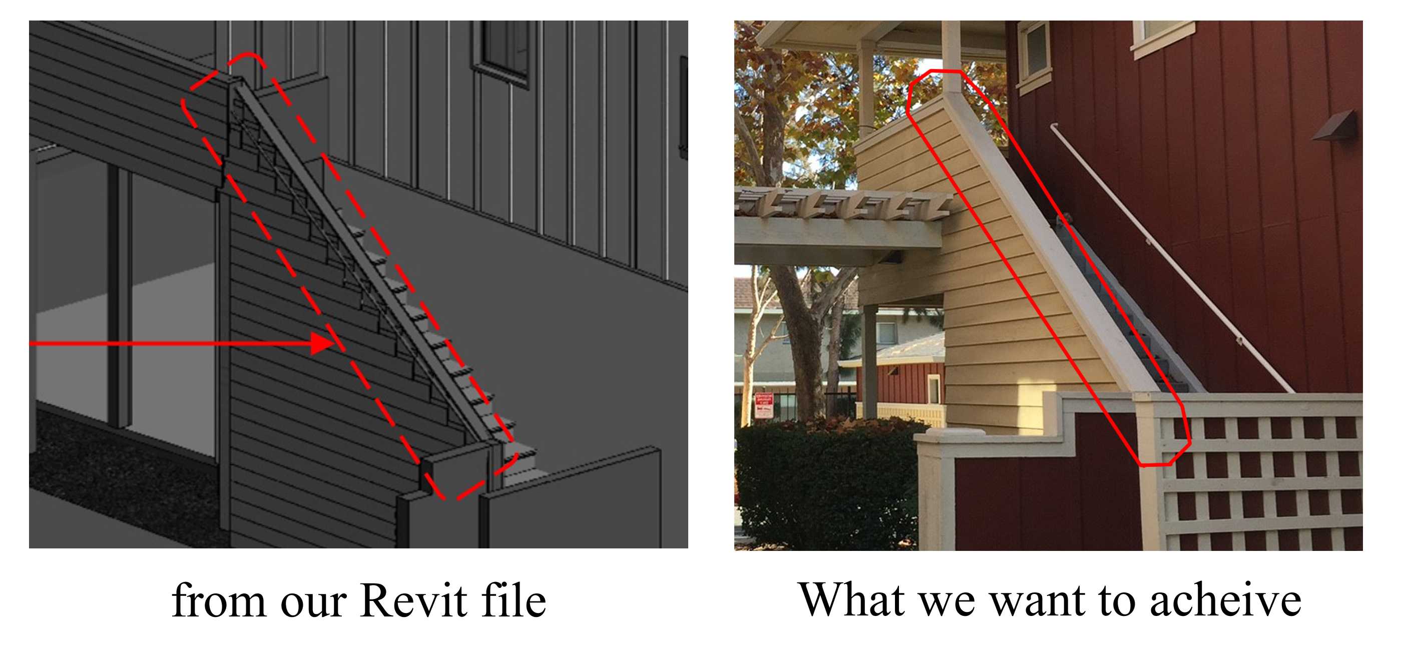

I need your help for the solid stair railing using sidings (please see attachment)
We are trying to cut it diagonally inorder to shape it together with the diagonal hand rail in which we couldnt figure it out.

DOn't use a railing.   Modify the wall and run the wall cap down that.
