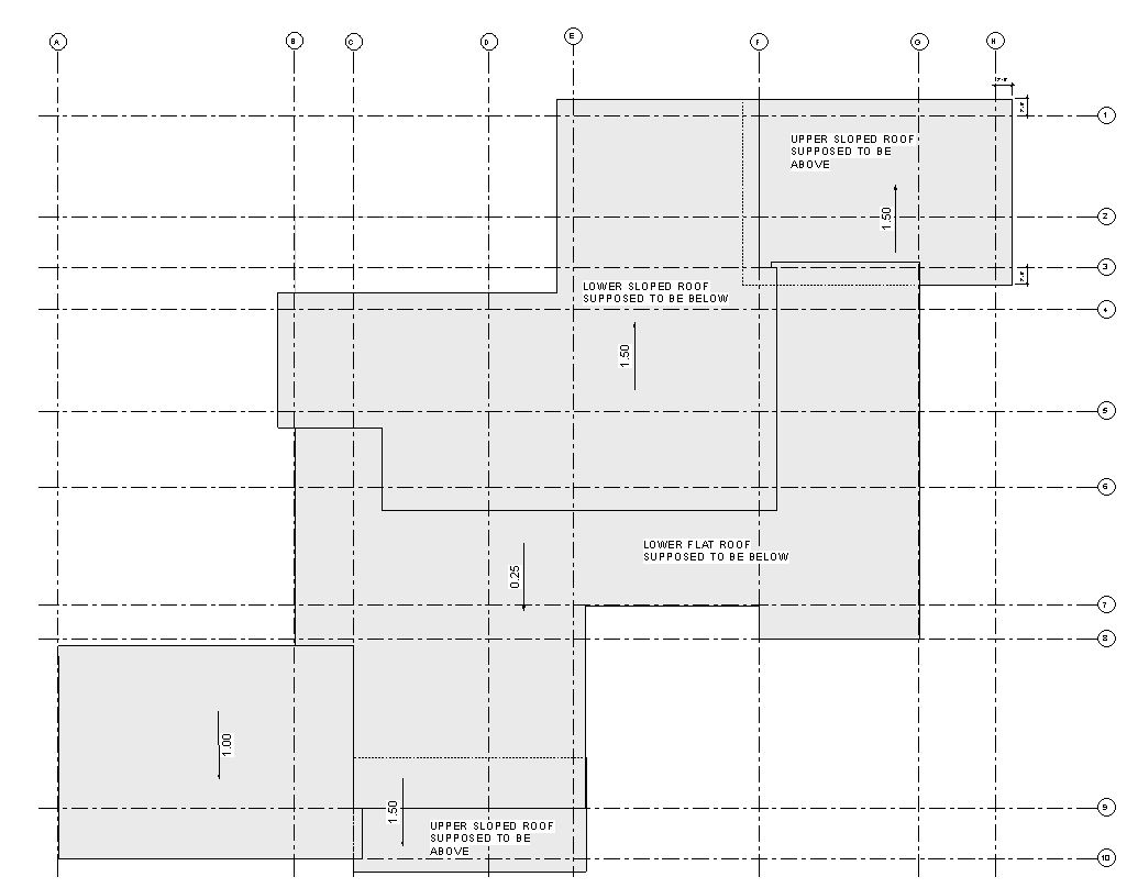

Hey All,

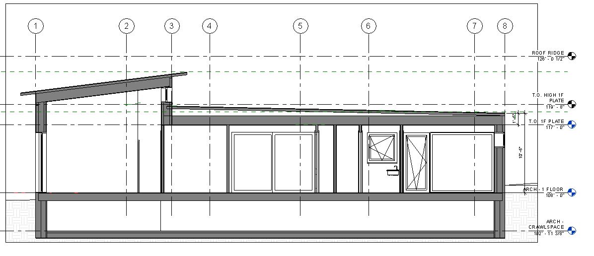

I've got a roof plan thast I'm having issue with. There are to high roofs that are above a flat roof below, but in the plan, they are showing as below the flat roof. I am wondering why this is happening! Ipl ayed with the view range a little, but I really cannot think what would cause this. Any help would be appreciated! Attached is a capture of the roof plan, and a section coing through the right side of the roof N/S.
Thanks,
Garrett
Thu, Dec 10, 2015 at 3:07:35 PM | Roof Plan Issues- lower roof showing above upper roof
Your question is not very clear.Look at your view's cut plane and view range settings.   Also see if you have an underlay on.
Thu, Dec 10, 2015 at 3:10:46 PM | Roof Plan Issues- lower roof showing above upper roof
fuentesdesign
Joined: Mon, Aug 23, 2010
0 Posts
Yes, I should have proof read all that. anyway, I just figured out the problem. for some reason the plan was in Wireframe, when I changes it to hidden line, the roofs showed correctly.
