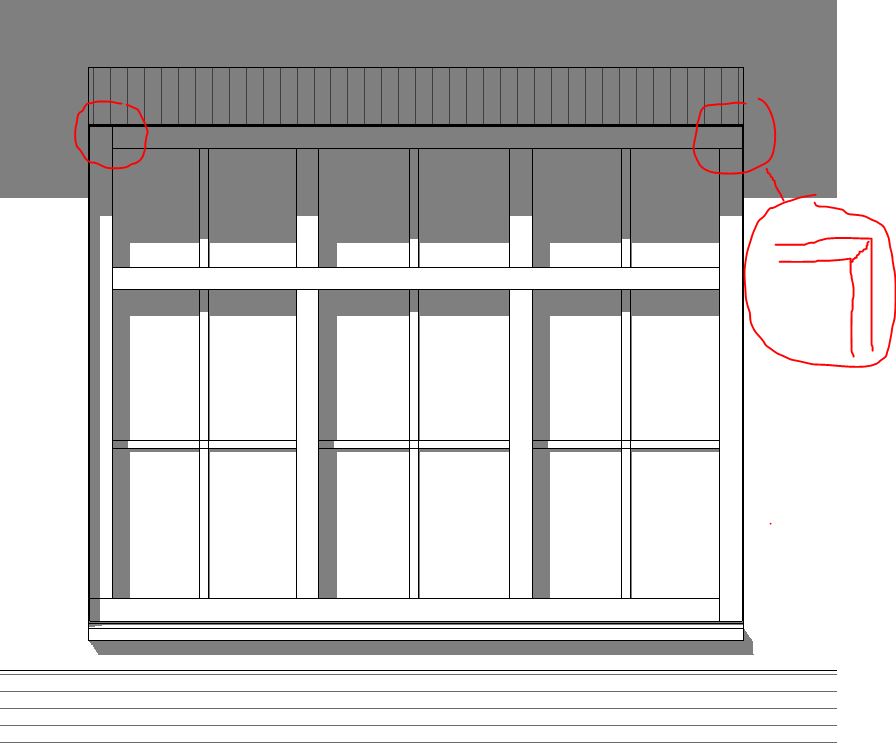

is it possible for a curtain wall mullion to not join horizontal or vertical, but diagonal? If we draw them horizontal, it's a wooden window. But our firm also offers PVC windows. The the mullions should join diagonal.
The image below shows what i want to achieve:
Thnx!

If you create a window family you can do exactly as you need.
With curtain wall it seems difficult. You may do a linework change to hide the joint, and do a annotation line 45 degrees.

Sorry - the answer is no.
