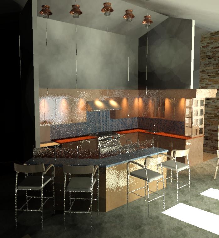

Hi guys, I'm finishing up my house project for school and trying to get renderings done. I have some lighting fixtures in my kitchen that aren't showing any materials on them and I can't figure out how to apply them. I was hoping someone would know what to do.

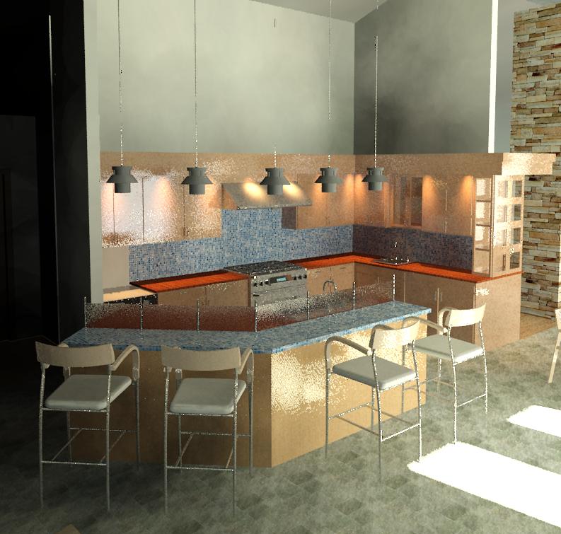

In my rendering you can see there is no material and in the image I provided you see what it is supposed to look llike.

That's just it, I tried that, the only part that had material assigned to it was the down tube. I had to explode the fixture in order to apply material to it, but then it lost it's ability to adjust the length and ended up looking like the rendering below. Doesn't matter anyways, this fixture is system based, so I can't turn the light on with out making an actual electrical system and we're not doing that. I'd be better off making my own in autocad. Does anyone know if I put a point light in a fixture in autocad if it will transfer over to Revit?
