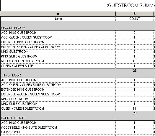

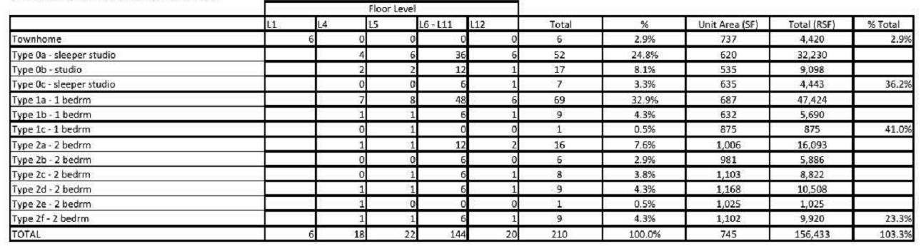

I'm trying to create an area schedule similar to the one that is attached. I was thinking I could create a new schedule for each level that breaks down the count, but I can't figure out how to give the units that aren't on a specific level a count of 0. Is there an easy way or workaround?Thanks in advance.
Tue, Dec 8, 2015 at 11:51:01 AM | Schedule by Level?

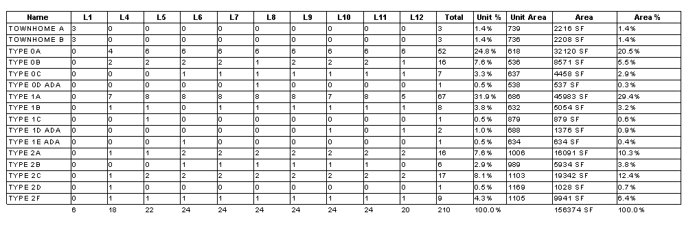

First, a Revit schedule will not look like that.
You can schedule both rooms or areas by level similar to what I have below.  You could have a column for areas.

I think I actually figured it out. Ended up creating 0 SF areas for each unit type on each floor and creating a calculated value for count using if(Area=0, 0, 1) and calculating totals which gave me an accurate count.
It's a little more complicated than that, but it works!
