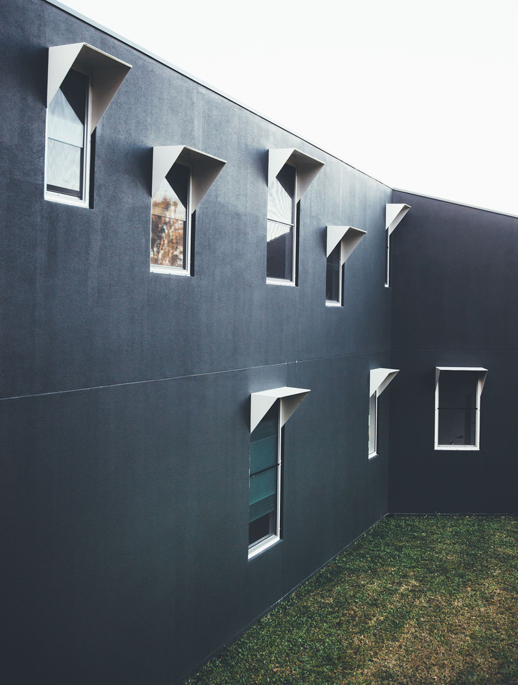

Hi everyone!
I'm wondering if anyone could help, how would you create this type of elements above the windows
thanks!
Julio
Thu, Dec 3, 2015 at 7:33:19 PM | HOW TO CREATE THIS ELEMENTS
julio3h
Joined: Wed, Jul 16, 2014
0 Posts
FOUND IT!
Using the Model-In Place tool do the trick
Thu, Dec 3, 2015 at 7:48:46 PM | HOW TO CREATE THIS ELEMENTS
DavidBruinsma
Joined: Sun, Jun 3, 2012
13 Posts
5 Stars: 1 Votes
I would create a WALL HOSTED Generic Model so that you can copy a single family around your model.
It would always host to the side of the wall you select, you can also perfectly align the centre line of the hood family with your windows (i would build the family with a centre left/right reference plane of course), and adjust its height above the floor level all from the external elevations.
Fri, Dec 4, 2015 at 3:51:42 PM | HOW TO CREATE THIS ELEMENTS
julio3h
0 Posts
DavidBruinsma
Thanks! im gonna try that this weekend, seems that it is a smarter way to do it
