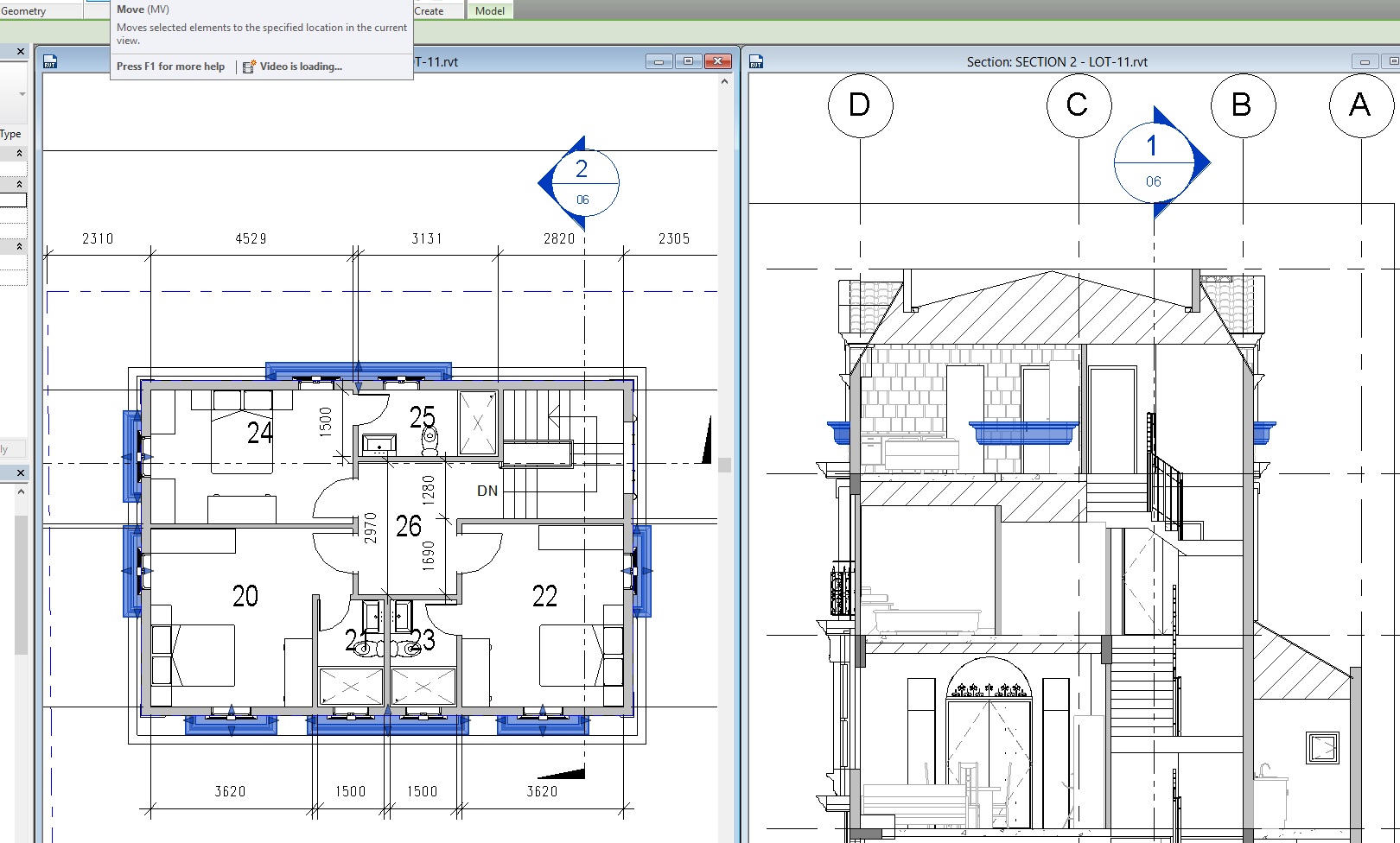

I have been doing this section in my Project, however the Generic model that I have placed is still showing in the section view even though It is behind the cutting line.  Everything in the View is correct and show perfectly. except for the ones in blue color (Please see attached image thats the generic model)

From YOUR HELP.  So if you read that, you will see that if any portion of a non-cuttable family, including invisible lines, is cut or in view, then the whole family is shown projected.
