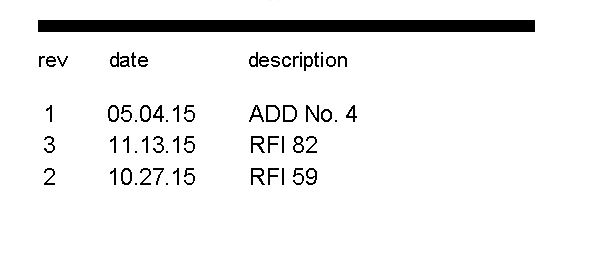

I'm using Revit 2014 and I needed to add a revision to my title block that was going to be out of sequence. The revision was added to my model by going to VIEW>REVISIONS>and in the "Sheet Issues/Revisions" window that appears I added my revision and used the "Move Up" button to place the revision in the correct Sequence, Date and Description order. However, when I look at the Revision area in the titleblock the order is incorrect. (see attached jpg.)Please help.

Pay attention to your sort settings in your revision schedule in your titleblock.  Typically the sort may be by sequence or by whatever.   We don't know what your "Rev num" is or if you sort by that but you do.....LOOK
