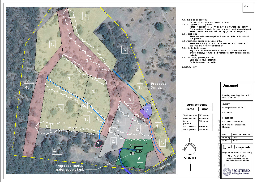

Hi
I am using Revit 2014
I am having trouble getting my selected view to print to pdf looking the same as what is on screen, that is with transparent fill. Why when i print to pdf does the transparent fill always come out as solid fill?
Any help would be appreciated, thanks
VND

In the print setup dialog box, try using raster processing instead of vector.

thanks mate, that worked.
