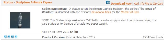

I would like to scale this family downloaded from Revit City to the size I need (approx 300mm). Apparently it's simple according to the family blurb! How please?
Wed, Nov 25, 2015 at 6:52:16 AM | Scaling Revit family
If the family is not parametric then you have to edit the family.  Without looking, I expect this to be a CAD (skp) file import in the family.   Edit the family and scale the import.
