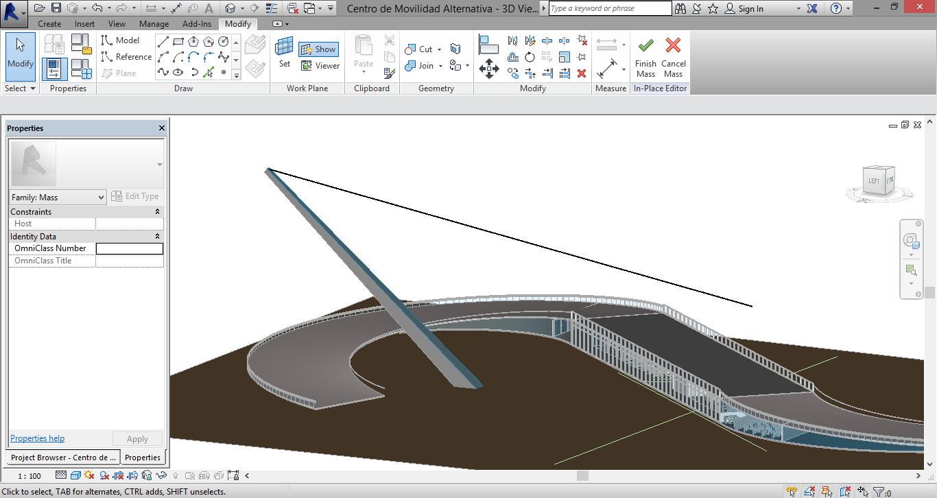

Hey guys, what's up... I'm a newbie who is looking for some help...
I'm trying to model sort of a cable stayed structure for my college's final...
So, the thing is that I'm having issues to correctly model that little piece of s.. xD
__
Please, could someone tell me which is correct way of doing it?Specifically to model the wires that supports the building.
Thank you very much !
Btw I'm using revit 2016
Thu, Nov 12, 2015 at 12:07:11 PM | Modeling a kind of cable stayed structure
Wires are a problem because they are so small.   I created a wire (rod) family (non-hosted) that is a simple sweep using a instance based, length parameter.

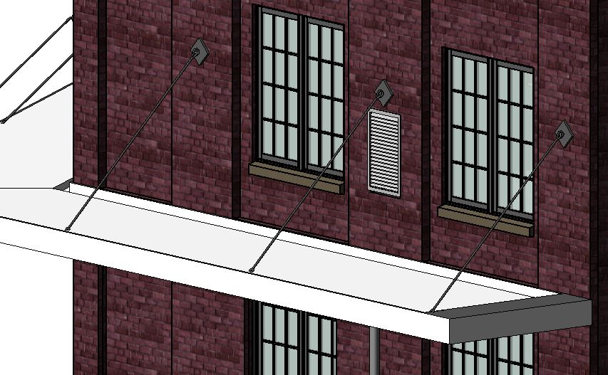

Thu, Nov 12, 2015 at 12:18:26 PM | Modeling a kind of cable stayed structure
My rod family with eye ends used to support a canopy on a hotel.
