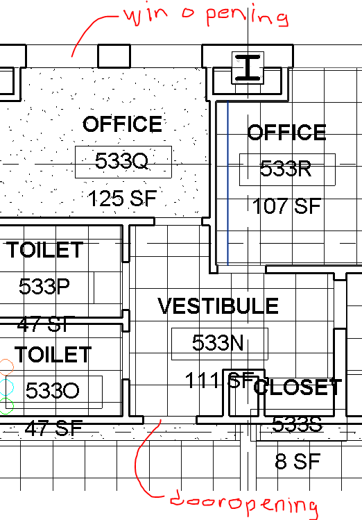

I am sure this topic has been broached before but i searched and could not find an answer. it appears that door and window openings (not the doors and windows themselves) are appearing in my reflected ceiling plans and i cannot figure out how to make them disappear any suggestions?

Change your RCP view cut plane to above your doors and windows.

Thanks WWHub, i thought of that but the windows are taller than the ceilings (historic building with bulkheads). i suppose i could use plan regions but i was looking for a simpler solution.

Plan regions are your answer then if you can't move the cut plane up high enough.
