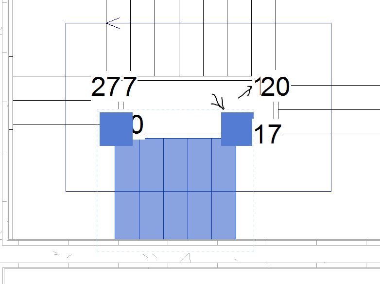

Hi everyone- thanks in advance for your time... Anyone know how to elimate these labels (see attached image) while in the create stair mode?  They are so intrusive, it hinders editing the stairs...  I've checked all the property panels, etc etc.  Been using for many years, this seems to only be an issue with the most recent verisons.

I don’t think you can turn them off, but you can temporarily change the view scale to a ¼” or so, while editing.

Yes! Thank you, that option did work! So simple!
