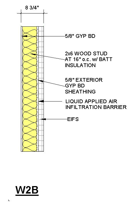

Anyone know if there's a way to schedule wall layers other than as a material takeoff in the latest versions of Revit?
I would like my wall schedule to report GWB layers and thickness as well as stud width.
I know it was a wishlist item a few years ago.

No way that I know of.   That's why we use legends with material tags set to do this.

Thanks.  Yeah we have those too, but we're trying to move away from them to something more schedule / general note oriented.
Perhaps 2017.
