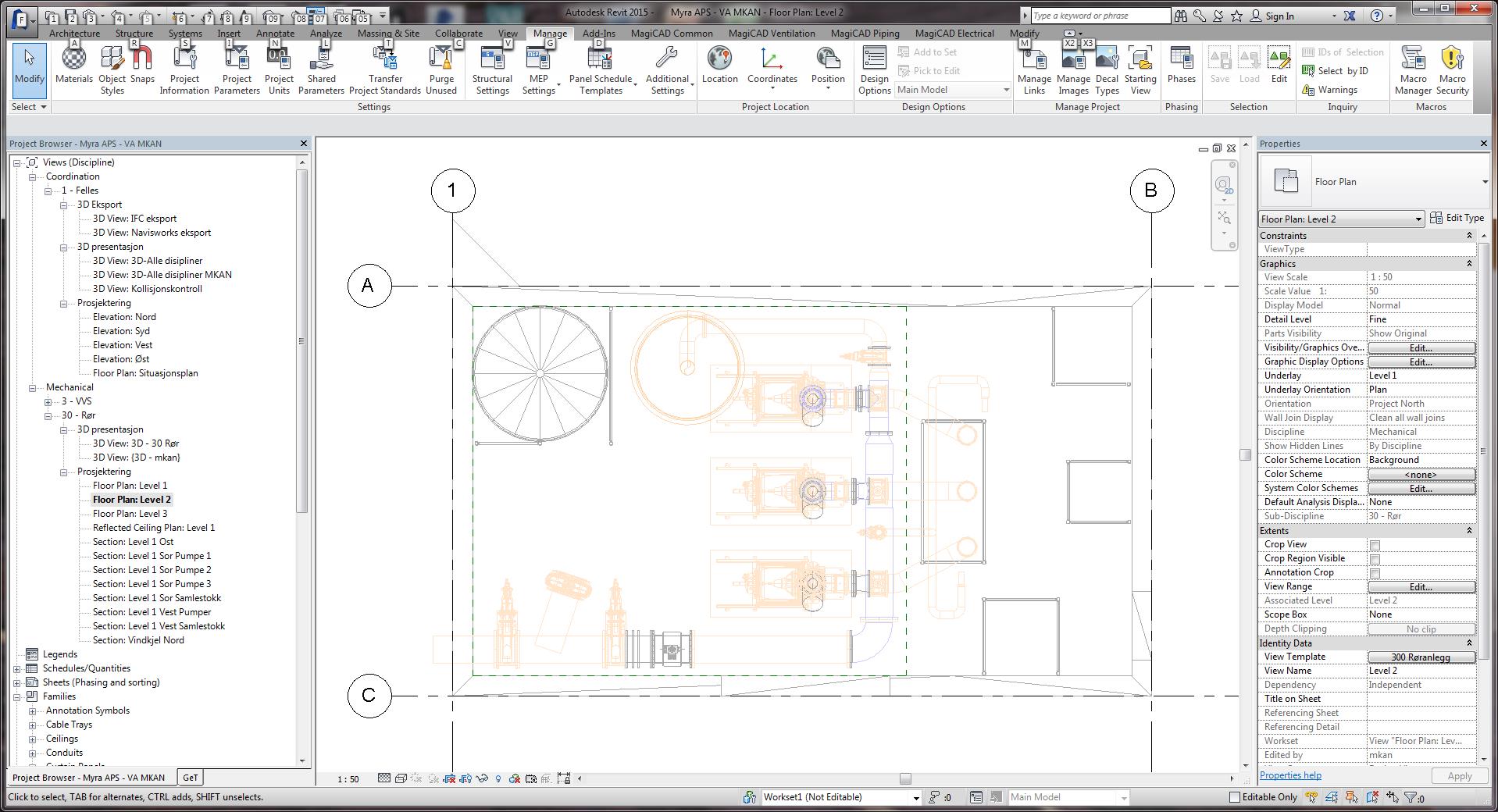

I'm building a pumping station for wastewater with two major floors. My floor plan called Level 2 should not show all the equipment on Level 1. How do I hide them without having to click on each item to "hide in view"?

Turn off your level 1 underlay.  View properties.

Great! That was almost too easy. Thanks a lot
