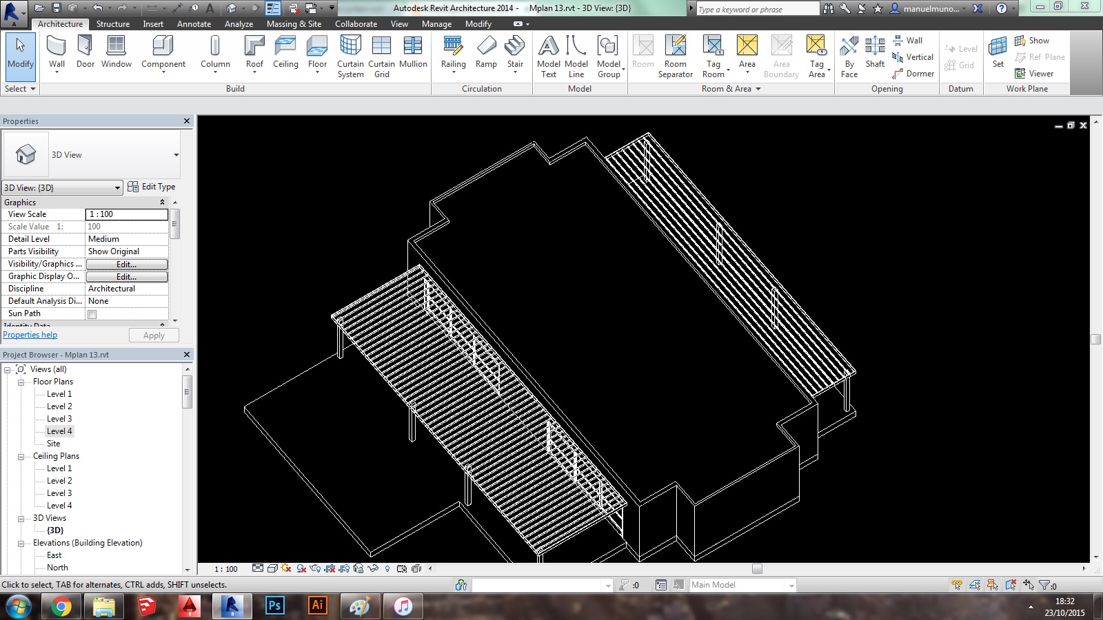

Hi, I have a bit of a problem with Revit. I'm trying to make a pergola for this project, but Revit changes the axis of the curtain systems I'm creating. As you can see in the attached picture, the larger pergola is on the right direction, but the smaller one is rotated 90º. I've tried creating them separately and as parts of the same system to no avail. I've also tried re creating the mass. Is there any workaround this or I just have to give up and duplicate the system type changing the grids?

Option 1: Delete the wrong one, copy the right one across and resize to suit.
Option 2: Go to plan, edit the profile and copy the purple sketch lines, exit edit mode. Rotate the pergola 90 degrees and edit the profile, delete the existing sketch lines and paste into the same place the one you just copied.

Thanks!
