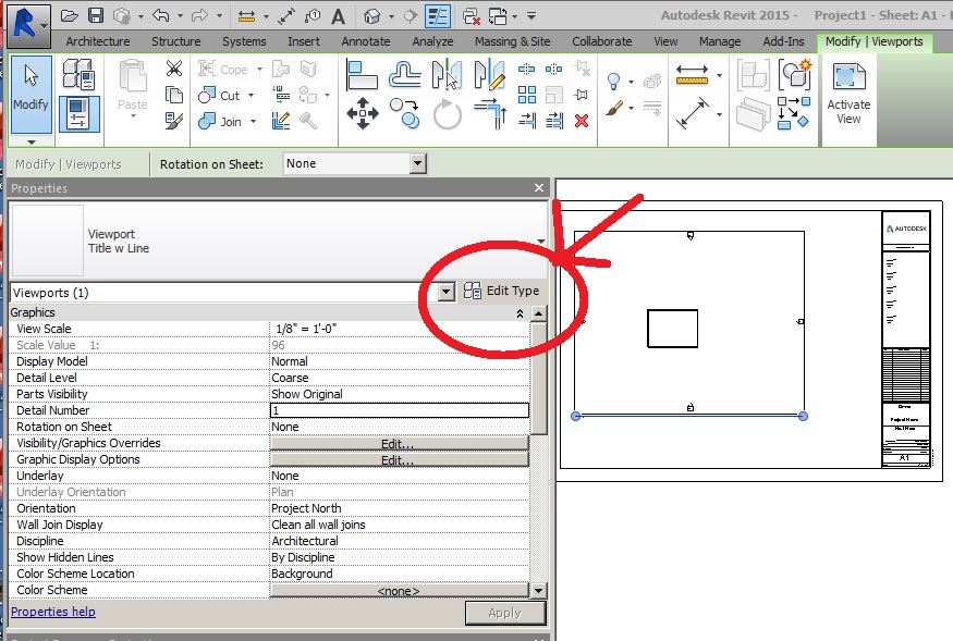

To make a certain print, I somehow turned off the view titles.  I think I selected the view title family and right clicked its visibilibity and reset it to "off".   Now it is invisible, and I can't find a way to turn it, along with EVERY other view title in the project, back on.
Anyone know how to back out of this?

Click on a view on a sheet and the view title will show in the properties window.   Re-edit the type or change it to the correct type.

"Edit type" doesnt look like a selectable button, it doesn't look that way...  https://goo.gl/JPhBOu
Wed, Oct 21, 2015 at 12:11:46 PM | Viewport Titels are OFF
I don't know what or where you are looking.  See attached.
