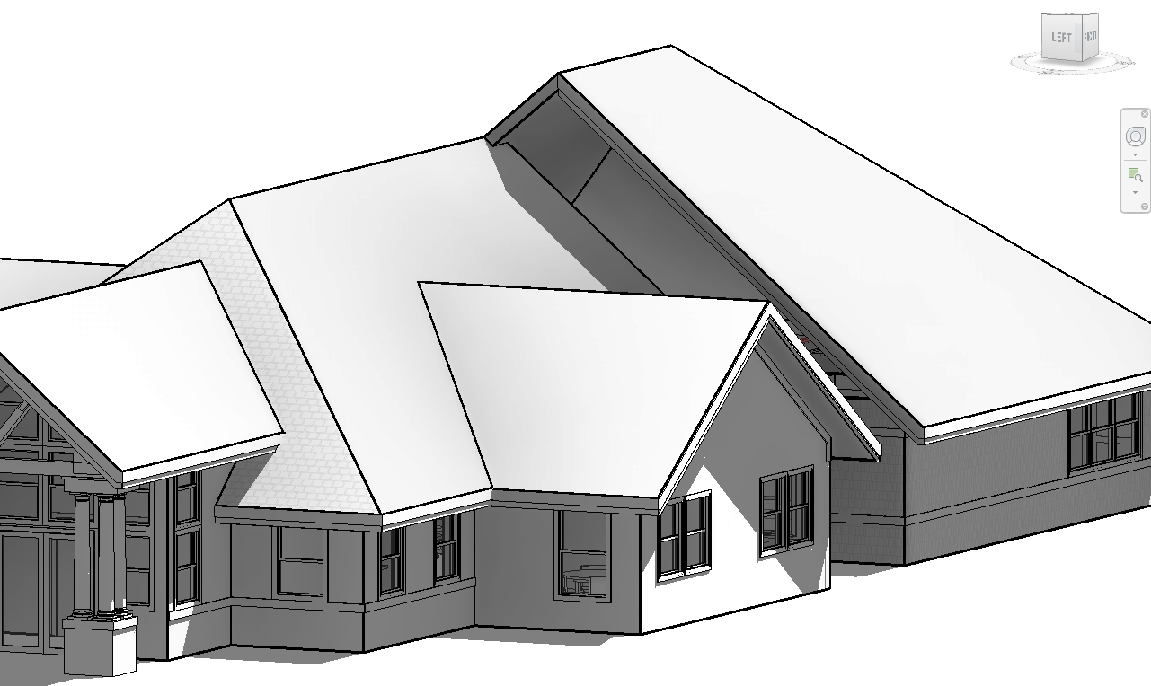

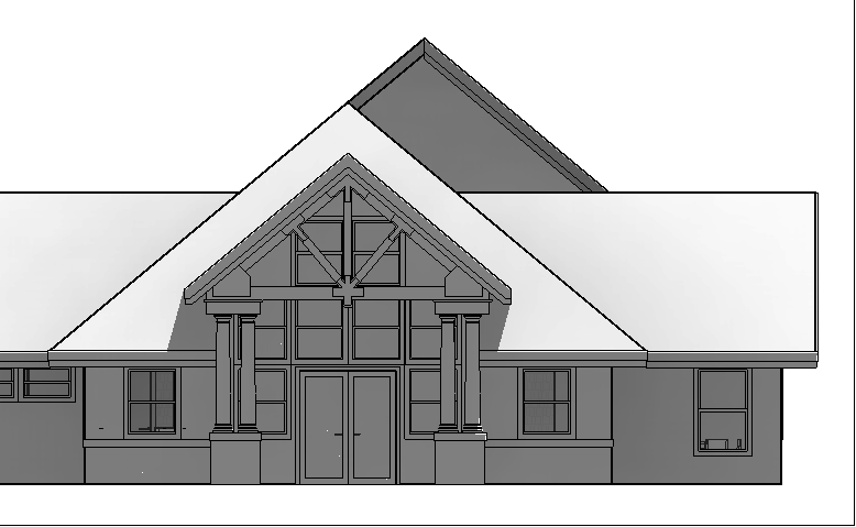

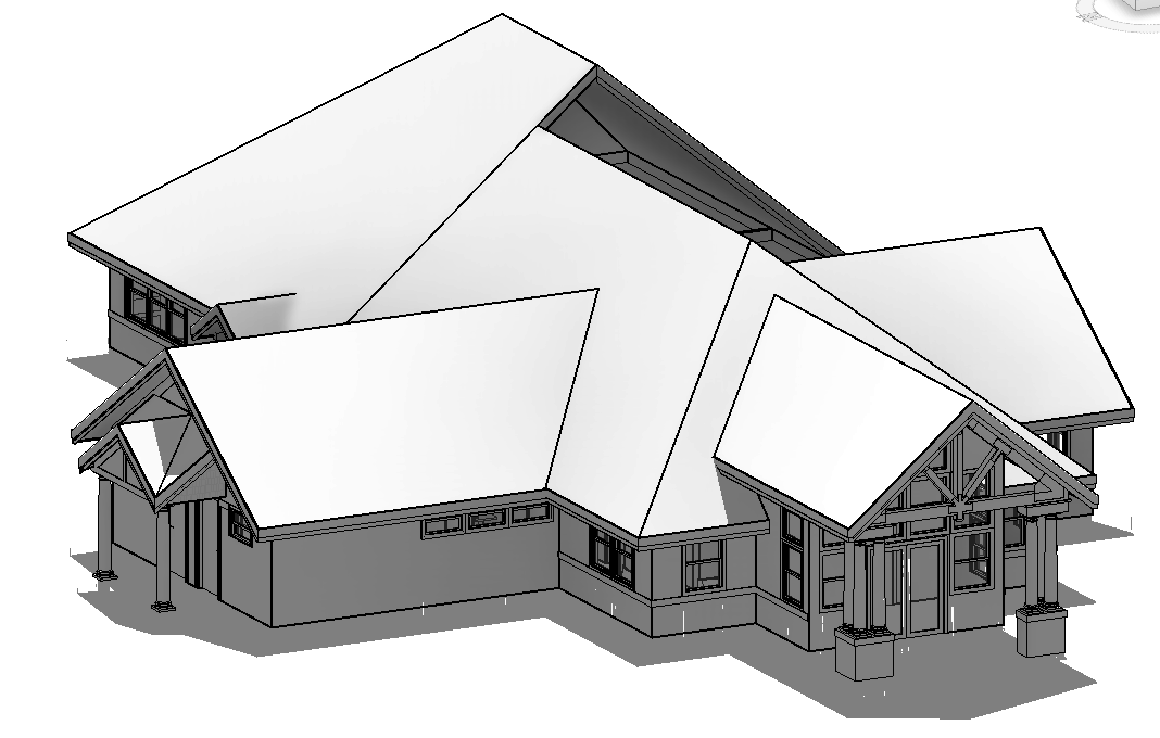

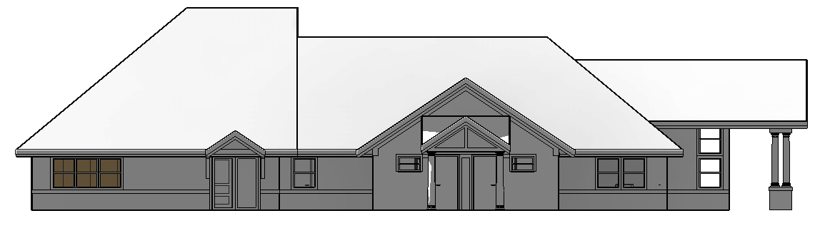

Hi All - I have an existing roof and a new roof that I need to join. They share the same slope, therefore they share the same roof line on one side (please refer to posted images). They will not join using the join roof tool. When I received the error message, I got rid of all of the culprits (i.e. connected walls, fascia, etc.) and STILL they will not connect. I've even tried changing them both to new roofs incase you couldn't attach the existing to the new. Is this possible to do? Any help would be great. Thanks!
Tue, Oct 20, 2015 at 12:06:05 PM | Cannot join two rooflines - one new and one existing.
Without any text, your images don't tell us anything.
You say they have the same slope.... so what?  If they are not on the exact same plane, there will always be a line.
You say you got an error meassage but you don't tell us what it said.
What is your view setting?  Phased will always show a line between phases.  Show complete should be your setting.

You are using the 'Join' tool and not the 'Join Roofs' tool right ?
In theory they should be able to 'join' but this is the type of issue that's hard to trouble shoot without plalying with the model. Of course you can always use the linework tool to hide the unwanted lines.

Wow. Ok, first:
WWHub: I stated in my question that they share the same slope AND ROOF LINE - pardon me for not being more descriptive and explaining that means the exact same plane. I included these images to explain to people that it is not the case of joining a gable to a gable at a 90 degree angle. I didn't tell the forum what the error message said because I received 18 error messages all pertaining to the main and important fact that the roofs would not join. Show complete IS my phase filter setting. All I wanted to know is if this type of roof addition condition was POSSIBLE to do - I wasn't asking for miracles on fixing it. I have come to RevitCity forums for help in MANY cases throughout the past 4 years and usually gain a lot of new knowledge from YOUR responses, inparticular. This was my VERY FIRST time posting my own individual question, because I could not find a straightforward answer to the question (which, let me restate, was: IF THIS IS POSSIBLE). I am not a novice and I have now been deterred from posting again thanks to your snarkiness.

'Join Roofs' will definitly not work for your situation. It's just not meant to do that.  Use the join tool and select each roof instead and if they line up exactly and they are the same roof type the the seams will dissappear.
You can use the 'Join Roof' and the 'Join' tool with roofs from different phases.

Thank you dgcad - I did try the regular join tool, per your instruction, but even that is not working. I think I will be able to get away with hiding the line in my elevations for now. Thanks for your help anyway!
Tue, Oct 20, 2015 at 2:04:45 PM | Cannot join two rooflines - one new and one existing.
Caroline,
Your images show many roofs and there was no way for us to know what any two roofs would not join.  A few added text noted would have explained where the problem was.
You say the two roofs are on the same plane.  A simple very close section could have prooved that.  Since they did not join using the join two, either the two materials are not the same or they are not on the same plane.   Cutting a simple section is always easier.
