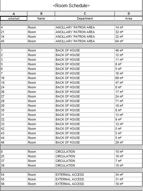

I've attached a screenshot of my latest 'issue'.
I'm working on a Sportsclub that has a number of different departments. I've had no issue creating rooms, tagging them, scheduling etc ... where I'm stuck is how to get a grand total of areas by department.
The reason for this requirement is for calculating patronage numbers (which need total area), and liquor licencing (also dependant on area and patron numbers).
Any help would be appreciated.
