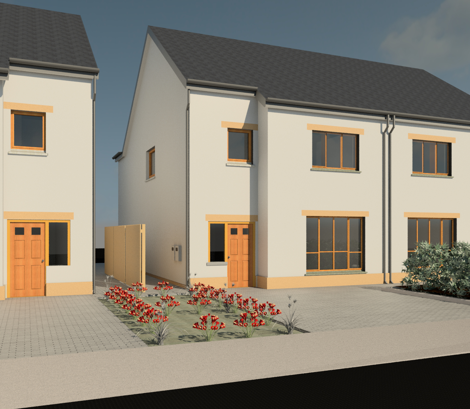

I am rendering a camera photo in revit in a cloud because unfortunately my computer is too slow at this moment, the render is for a brochure im putting together.
my question is... in the photo i have attached the colours are not as strong or defined as i would like, for example the roof, downpipes and fascia and soffit are kind of washed out, i also would like the tiles/slates to be horizontal and more defined. if anyone could help or if i could message someone, it would be great,
thanks,
Cillian
Option 1: Go to each material and add more colour
Option 2: Take your completed Cloud render and open the image in photoshop to enhance it.
Option 3: Use the Cloud render exposure option on the webpage to enhance image.
 I also would like the tiles/slates to be horizontal and more defined
You will need to rotate the texture within the material editor.
