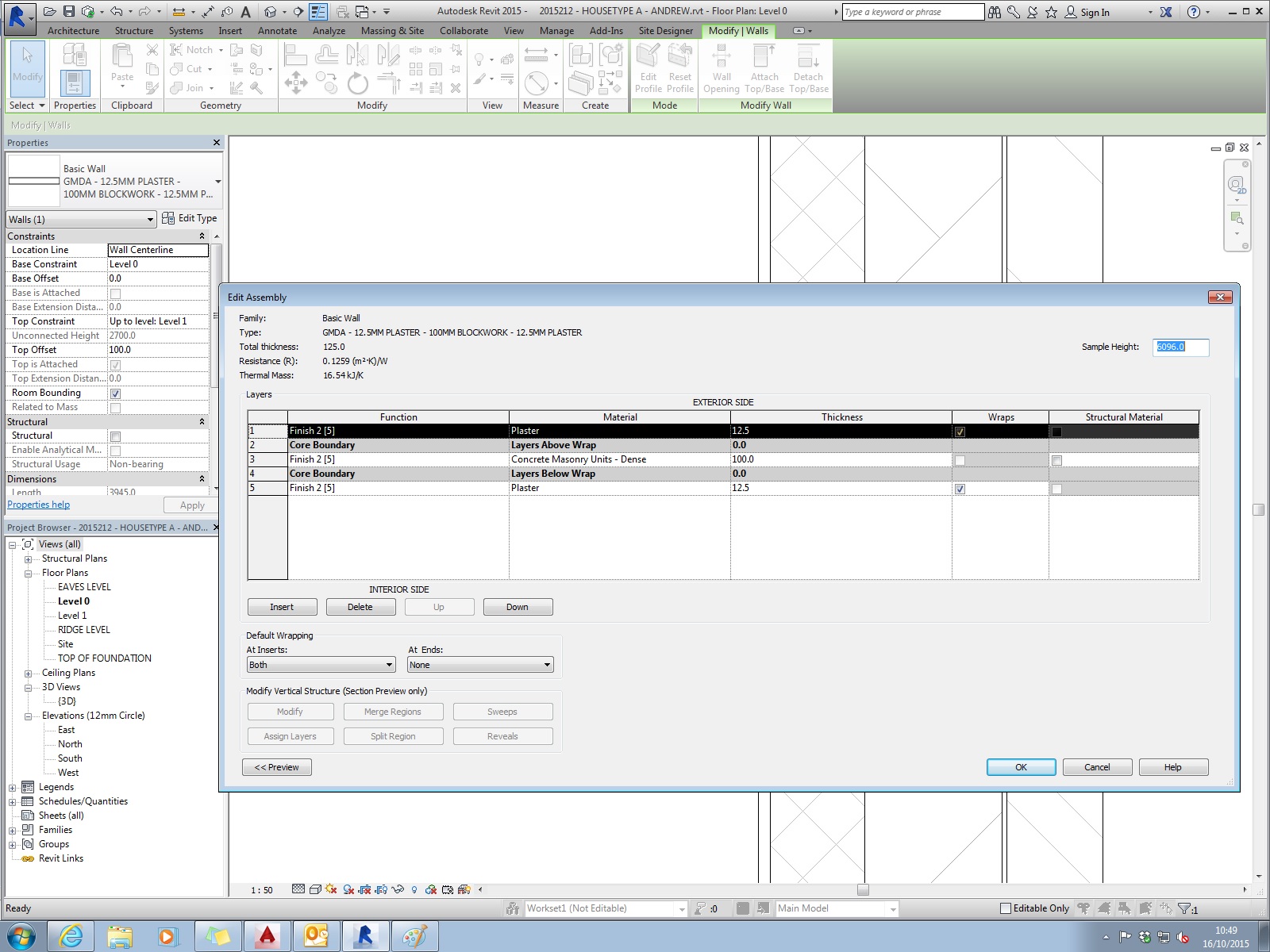

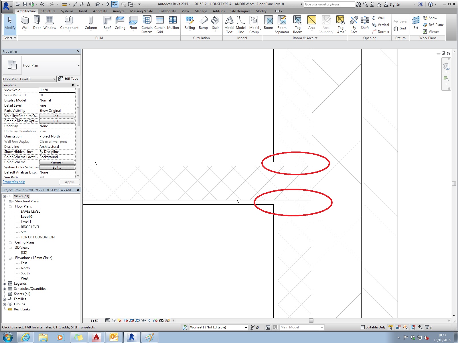

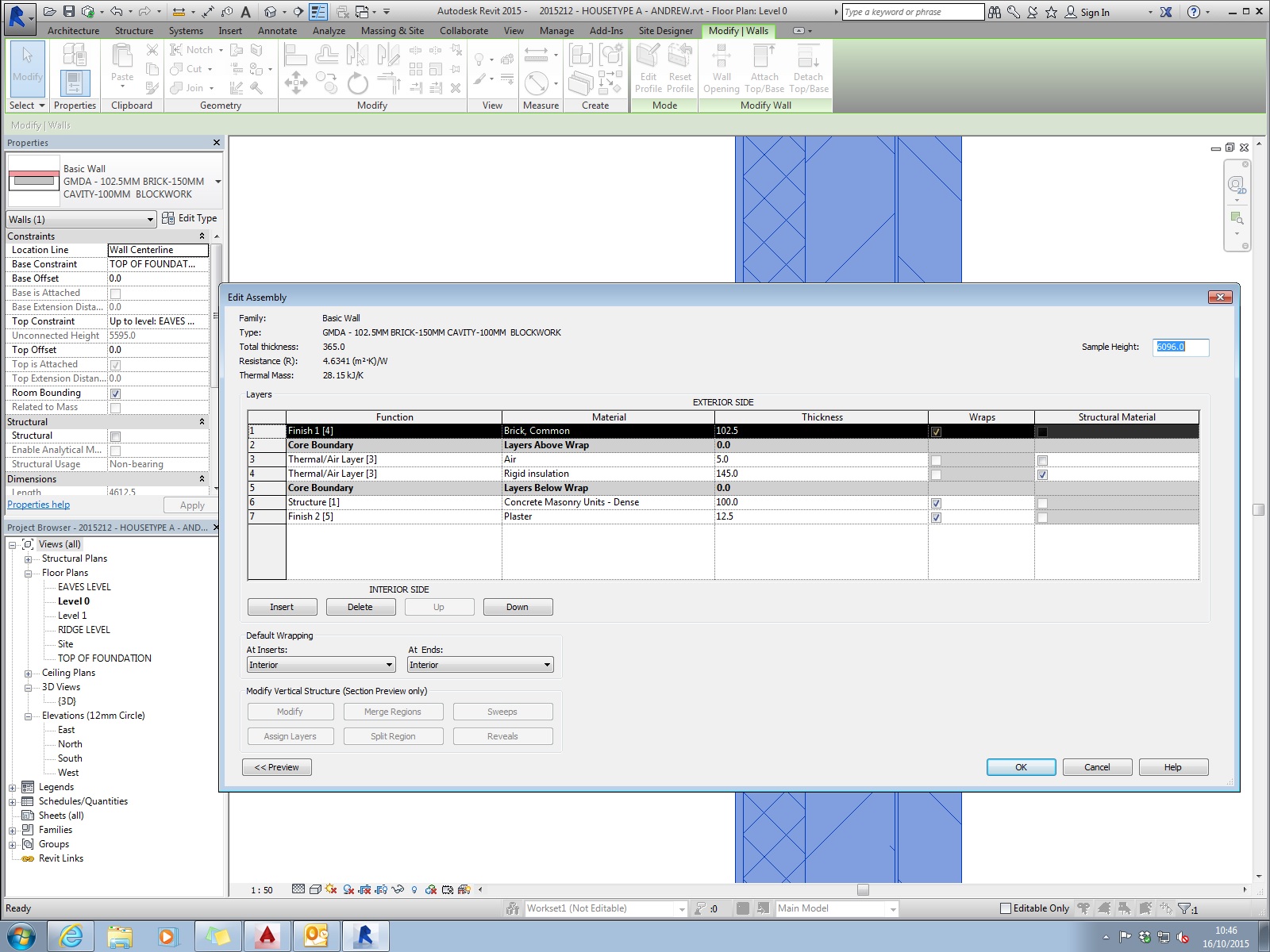

I am currently trying to resolve an issue we have came across when trying to get the internal blockwork to wrap at the jambs for windows and doors.
The layer set up for the external walls have been set up so that the internal blockwork leaf is outside of the core boundary and it is set to wrap, this seems to work but when we have an internal blockwork wall meeting the external wall the blockwork continues through to the insulation, is there a good way to resolve this so that the blockwork joins ?
Or if there are any other suggestions on the best method to achieve jamb wrapping for external wall build ups as it is something we are struggling with.
