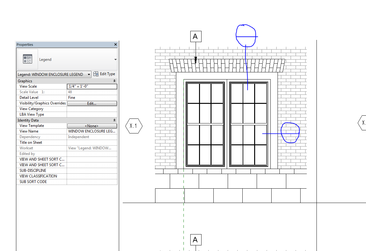

I have a Legend including all my window elevations and I would like to call out window jamb, head or sill detail from this view. I've already had those details. I was planning to ref. those views from the legend and found out I can't do it. Is there a way to do it or I have to make those window elevation in a draft view?
Thu, Oct 15, 2015 at 5:45:23 AM | Can I call out from a legend view
You could use callouts from elevations and hide the callouts in the elevation views.

I think I'll do that this way. Thank you!
