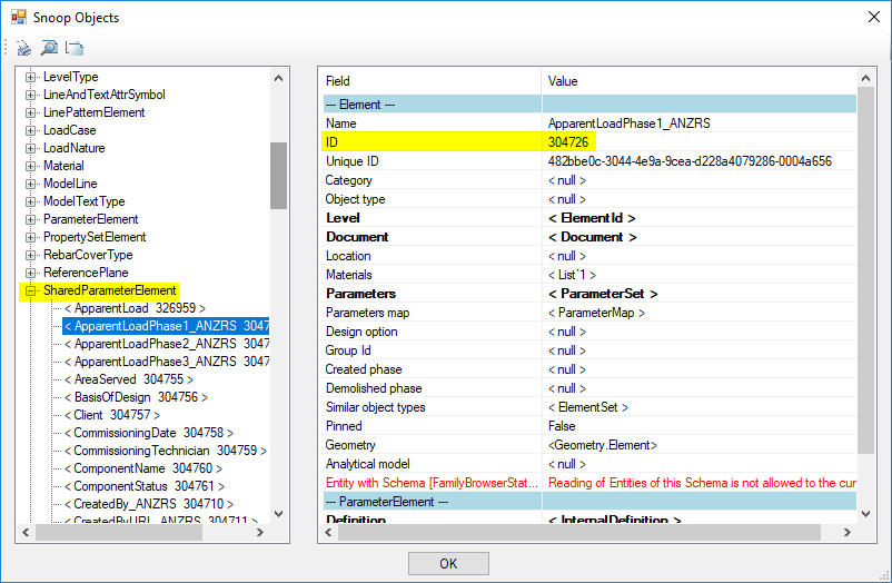

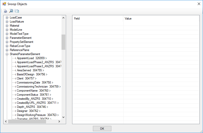

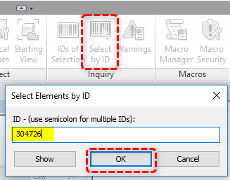

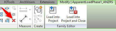

I know this thread is quite old, but the issue can occur any time and with any version, so I thought I supply a fairly simple answer for Revit 2016 and newer.  The issue is as described by Richard.  The problem is deleting the parameter out of the family does not solve it, as in the background Revit holds onto the shared parameter after it is deleted or replaced. The solution is to use revit Lookup which can be downloaded here  https://www.revitcity.com/forums.php?action=viewthread&thread_id=35514
NOTE: this issue will only happen if the shared parameter file has been manually edited via a text editor, so DON"T!
SOLUTION:  If the parameter is important than I suggest you replace the parameter with someting else. Then with the family open for editing run SnoopDB from the Revit Lookup tools.  In the left panel expand out "SharedParameterElement", select you problem shared parameter and get its ID.  Now go to the manage Tab in Revit and run the Select by ID tool and enter the parameters ID and click OK.  The Modify ribbon will become active and you can now click the delete icon.  Running SnooDb again confirms the parameter is indeed deleted
