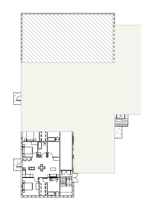

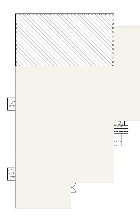

Hi, I'm experiencing some difficulty when printing. I have solid-fill Fill Regions which are set to transparent (Image 01), but when I print, they show up as Opaque (Image 02).
I've tried setting them to opaque and adjusting the transparency with a graphic override, but it prints the same way.
There are only two sheets that are doing this - the other sheets are printing fine (Transparent Filled Regions printing as transparent).
This is the third project I've had do this and have not been able to figure out a solution. Any help would be appreciated.

The problem occurs when I print to both PDF and our regular printer. I'm not sure how to check the printer driver.
Printing just the view, and not the sheet, results in the same problem.

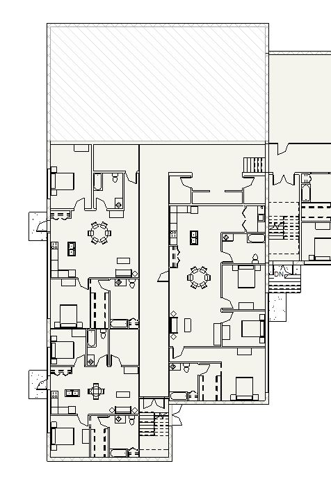

Here is the view in the program. As you can see, the Filled Region pattern is set to Transparent.

Sorry but this must be something in your system.  Is there a way to print this from another computer?
Have you ever audited your file?
Is this what Revit? .... Again, as I said earlier, chack your printer driver!
